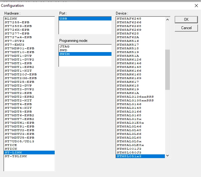

VIgor.1
Visitor II
November 18, 2020
0693W000005BtQkQAK.pngHello. and me have problem not working st-linkv3set for stm8. Mb1440B swim=on  jp4=1 & jp6=1 and jp3=1 up to 5v. Please help me i can't figure it out. i worked all-time with avrdragon and no have problems with use anytime. Usability and easy work. Stlink very hard work and many problem for me. And software no usability. Maybe lessons or movies helpful?
