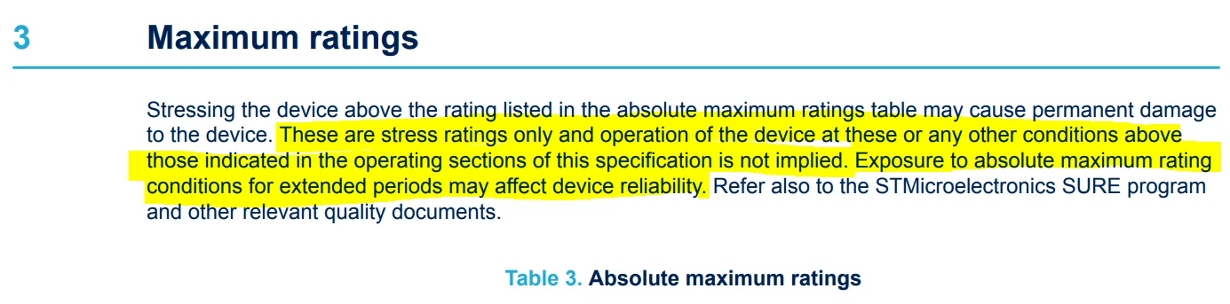

Hi, I wonder if the analog switch STG3692 can be used with +5V. I have concerns because recommended voltage value is +4.3V in the datasheet while absolute maximum is +5.5V, is there any risks about thermal conditions at that level? What do you suggest?

Follow the recommended operating conditions if you want to ensure proper operation. All datasheets have a similar statement about the "absolute maximum ratings":
