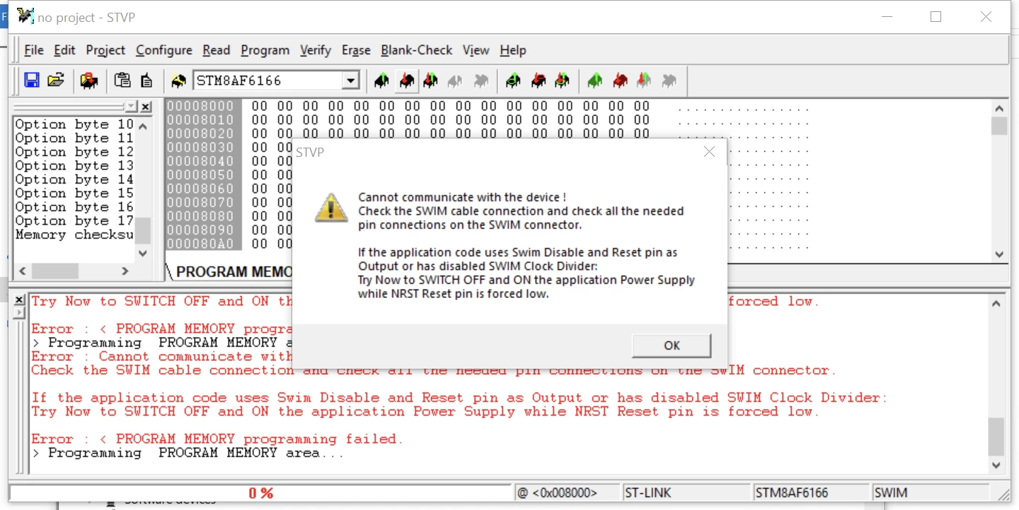

I'm using theᅠSTEVAL-ISB044V1 evaluation board for the wireless charging test. The evaluation board is based on STWBC-EP and can be programmed with ST-LINK V2. STM8AF6166 is the core of it, so I post here. I tried to program the board, and there's always a connection problem. It looks like the following:
I've tried a USB 2.0 port and USB 3.0port, and I can make sure I've installed all the required tools. Would you please tell me why there's a communicate error? And how to force the NRST Reset pin to"low"?

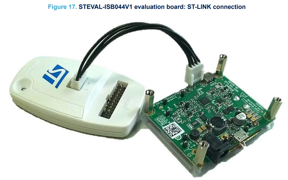

On the user manual of the board, the connection looks like this:

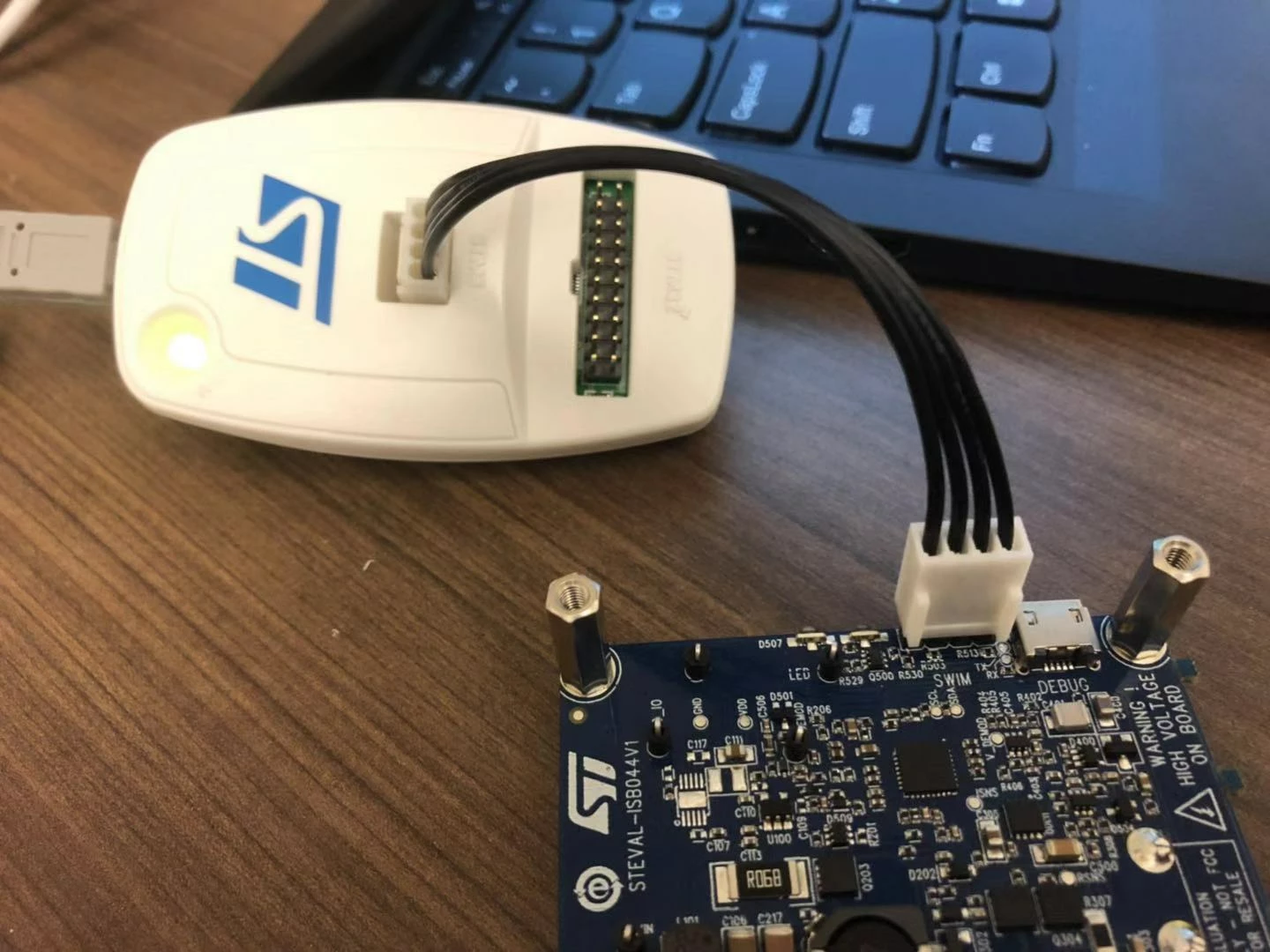

and here's my connection:
Although there's a communicate error, the light on the ST-LINK V2 is green. If I change the connection way, it will turn to orange or red.
Would you please tell me the correct way to connect the ST-LINK V2? Thanks.
