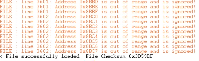

I use the ST Visual Programmer to flash a stm8S007C8 and this is working good, until the size of the .hex file is bigger than 155 kB. After this size the STVP shows an error/warning that it is out of range
'FILE : line 3602: Address 0xXXXX is out of range and is ignored!' (see attached picture 001). The range (0xXXXX) starts from 0x8000 until 0x8BC7 (this depends on the size of the .hex file). If I flash the stm8 it's not starting because its overwrites/ignores the interrupt vector table. I have 6 kB left on the memory of the stm8 but i can't use it because of this problem.
Is there a solution how to fix this?
Thank you for your help.

    Max
    Feb 3, 2017 10:14 AM UTC
    Posted on February 03, 2017 at 11:14
    This is strange: this error should only happens if the addresses are out of the device memory range.
    but addresses 0x8BBD to 0x8BC7 shown on your picture are within the STM8S007C8 memory range.
    Are you sure you selected the correct part number?
    Could you share the hex file generating this error?
    The tool version may be useful too.
    BR
    Max

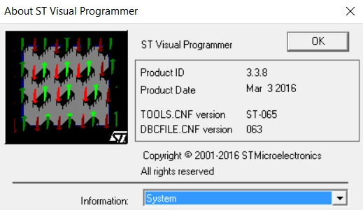

    Christian W
    Feb 3, 2017 12:10 PM UTC
    Posted on February 03, 2017 at 12:10
    Thank you for the anwser,
    yes that is what I thought too, but its not starting after I use this file. Sorry I can't send you this .hex file but I can try to create a new one with the same effect. I attached a picture (003) with all my settings (removed the .hex file from the screen and the names). Also you see in picture 0011 more warnings.
    The tool version is:
    ________________

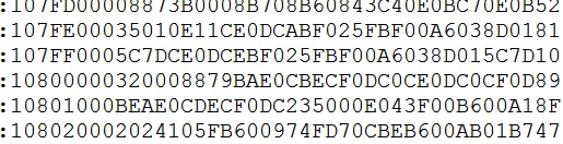

    Christian W
    Feb 3, 2017 3:25 PM UTC
    Posted on February 03, 2017 at 15:25
    Hi Laurent,
    I tested it with STVP 3.3.9 and have the same problem. I think If the full memory size is 155 kB then the hex file is not created properly and i should check more IAR workbench.
    This is displayed in STVP:
    and the hex file shows:
    I think that is the problem that the STVP dont know the range, and the hexfile ends with:
    and this is the last address that STVP shows as warning.  I guess the problem is not STVP more IAR Workbench that creates the file.
    Thank you for the advices.
    Can you send me your 155kB hexfile that I can check the addresses?
    Thank you for the quick help. Good team here.
    Regards
    Christian
    LaurentL
    Feb 3, 2017 3:36 PM UTC
    Posted on February 03, 2017 at 15:36
    Yes, that's what i meant too.
    Which compiler produced the hex file ?
    Or is it a file you received from someone else that can be wrongly created.
    Can you edit the hex file and put the lines at the begining ? For trials.
    Or removed them first ?
    Or review how you created the file.
