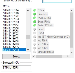

Hello
The link provided on this solution is broken
ST Visual Developer says ''out of memory'' and cra... - STMicroelectronics Community
My tool is crashing every time I open Tool->Programmer
Also tools are greyed in MCU selection
I'm testing on Nucleo board NUCLEO-8L152R8
Drivers are installed and STVP can see the programmer. I have problem only on STVD.
I saw many post of it, is there any conf file for the workaround?
Thanks
    1 reply
    November 6, 2025
    Found that
    A fix consists in updating the file stvd/ProgrammerAddOn.dll to version 1.3.3.0 joined​
    It worked.
