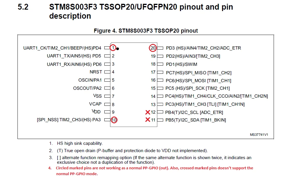

Some GPIOs in the STM8S003FS isn't working in the normal PP_OUT mode
I'm working on a project in which I want to generate some trigger output ( which is connected to a sound chip APR33A3). Hence, I'm using the controller STM8S003FS GPIOs to generate the trigger output. Unfortunately, for an unknown reason, some of the GPIOs are not working properly in the normal push-pull out mode. I've marked them in the Image attached below. The output of these GPIOs is staying unchanged (checked physically via multi-meter).
I'm also adding the snippet of my code, so, if I made any mistake please let me know.
The nor working pins are as follows:
  1. PA3 (HS)/[SPI_NSS] TIM2_CH3
  2. PD3 (HS)/AIN4/TIM2_CH2/ADC_ETR
  3. PD4 (HS)/UART1_CK/TIM2_CH1/BEEP

    First i would check if all pins of IC are properly connected/soldered to "board".
    Next I would investigate real status of pin. By connecting external pullup or pulldown resistors you can identify if output is in Low, High, or HiZ configuration. And check if there is any dependency on selected GPIO_MODE_)
    You can also check status of all configuration registers (CR1,CR2,DDR,ODR) if contains right values.
    BTW: All mentioned pins are Timer 2 outputs - strange coincidence - suggesting check timer2 configuration (if it doesnt control pins).

    Hello, I found the issue! for an unknown reason, some definitions were not successfully getting added during the preprocessing stage. So, I personally modified the definitions in the "stm8s.h" header file by uncommenting the #define STM8S003.

    At top of block with these macros is line:
    /* Uncomment the line below according to the target STM8S or STM8A device used in your
      application. */
    Everybody who want use "Standad libraries" should uncomment one line to select target STM8 family.
