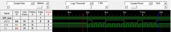

Hi all,
Is there anyone who can give me some advice about the STM8S SPI? I tried to setup STM8S105 as the SPI master mode with the hardware slave select management mode which is transmit only mode. Here my source code is below:
 /*High speed internal clock prescaler: 1, Fmaster = 16MHz */
CLK_HSIPrescalerConfig(CLK_PRESCALER_HSIDIV1);
CLK_PeripheralClockConfig(CLK_PERIPHERAL_SPI, ENABLE);
/* Initialize SPI */
SPI_DeInit();
/* Initialize SPI in Master mode */
SPI_Init(SPI_FIRSTBIT_MSB, SPI_BAUDRATEPRESCALER_8, SPI_MODE_MASTER,
             SPI_CLOCKPOLARITY_HIGH, SPI_CLOCKPHASE_2EDGE, SPI_DATADIRECTION_1LINE_TX, SPI_NSS_HARD, 0x07);
/*Enable the SPI */
SPI_Cmd(ENABLE);
/*Send data form a master to a slave */
while (SPI_GetFlagStatus(SPI_FLAG_TXE)== RESET);
SPI->DR = Data;
When I send data NSS signal is not going down but staying on high as below a picture. 0690X00000603OUQAY.jpg
Actually I also tested with NSS software management mode, but the result was same unless I controled PE5(SPI_NSS Pin) manually.
Is there something configuration that I missed?
I would be glad if you could give any ideas or advice about this subject.
