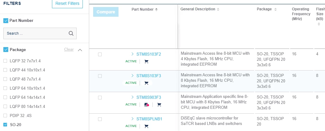

selection of micro controller with i2c sensor input,SPI DAC output x 2 nos ,external NVRAM and RTC interface

    I would like to have 20 pin 8 bit micro controller and external two channel DAC will be fine : My sensor is i2c interface and external RAM like 24C512 and RTC DS1307 will be OK

    There are some 8bit devices with 20 pins in different packages (TSSOP20, SO20, QFN20) available. Assuming you'd be interested in the package SO20:
    Main difference between S103 and S903: the latter one also provides an internal reference voltage measurement
    If SO20 doesn't fit your need please check the site of STM8 Microcontrollers and filter the required parameters on its left side, as you can see at the following example:
