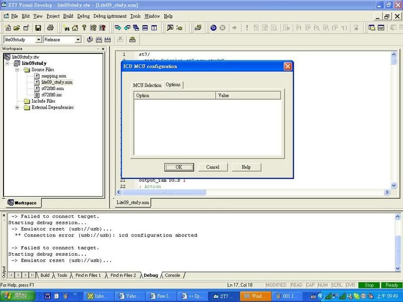

Our company bought 10 set of RLINK for half year. We had 4 set of RLINK are damaged, Do you have similar experience?
There are 2 type of response.
1) STVD7 cannot connect RLINK (may be power section problem, can i have the schematics to trace?)
2) Connected with STVD7, but promoted that, not right MCU selected, and the option table is blank, nothing to choice. (???)

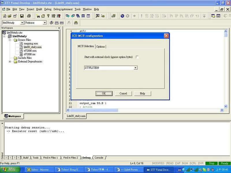

For my RLINK, it is being used well on Indartkit-LITE0 EVboard for such long time. My lastest RLINK had just already damaged before my last mail. For my own set, I think it is not RLINK problem, it should be my fault, because once i changed to the board ST7FOPTION-EVAL, the window(PC) was hanged (blue screen), after i reset and re-connect RLINK to IndartkitLITE0-EVAL & PC, the right bottom shown the USB devices cannot be recognized .....
I checked the other 3 set. here are the response after RLINK connected to PC
My Set & the Set 1 - USB devices cannot be recognized (descripted above)
Set 2 & 3 - After STVD7 start debug, RLINK LED ''power'' and ''busy'' are remain ON. And then STVD7 prompted a box. Picture attached below
