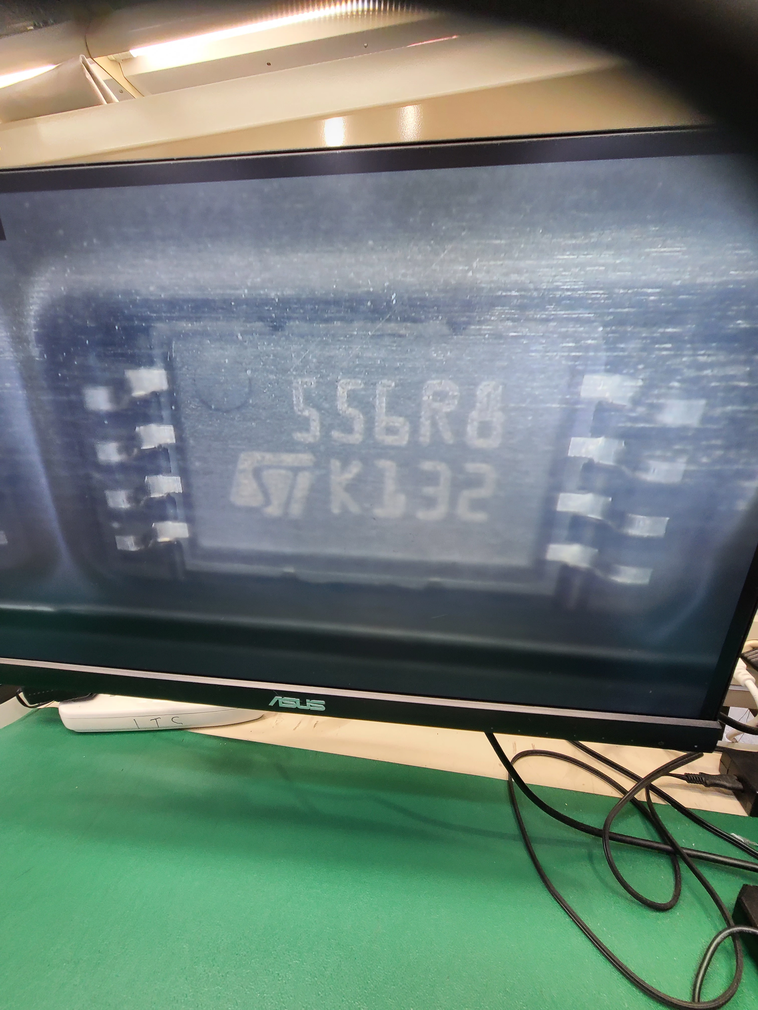

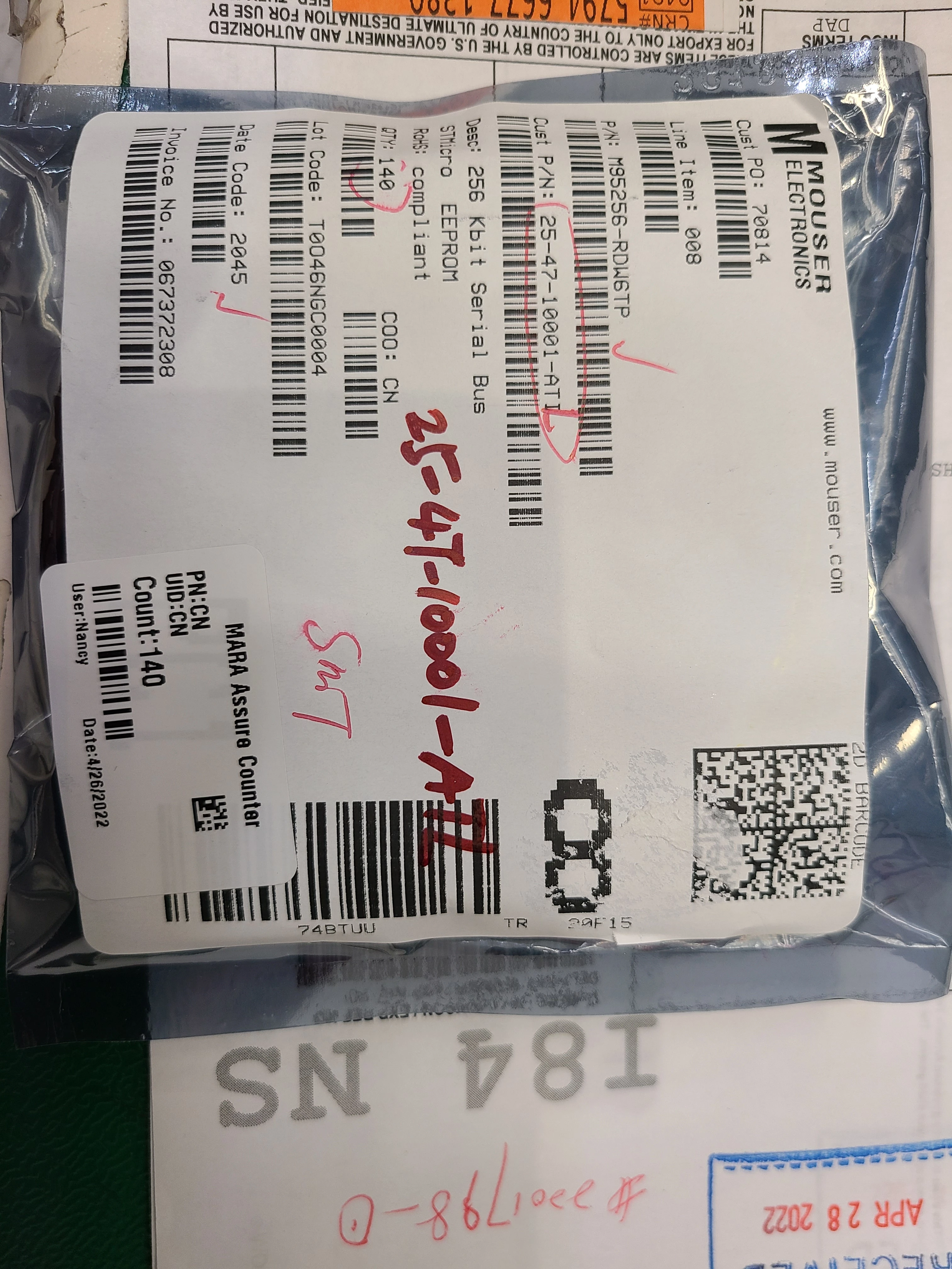

received some parts M95256-RDW6TP but body marking shows 556 we are trying to correlate if the right part was received. anywhere on website to locate info

Date code K132 is from ST & means manufactured in 2021, week 32.
Data code 2045 is from Mouser. --> I think you should ask them what it corresponds.

Seems consistent, any other letters? The Marking details have been poorly handled by the docs and this needs improving.

  • 556R8 is the correct marking for the ​M95256-RDW6TP
  • datecode on the device: 132 = YWW
  • datecode on the Mouser label: 2045 = does not match the dc of the device, needs to be clarified

0693W00000LzVhqQAF.jpg0693W00000LzVhvQAF.jpgi have attached images
