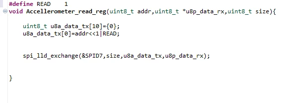

Good morning, I have some doubts about the functioning of the ASM330LHH. I can read the device id 0x6B, but only if I send this code: Fig1

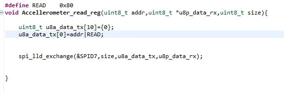

Why does it work for me? the data should not be written this way? Fig2
The microcontroller I'm using is an SPC58
