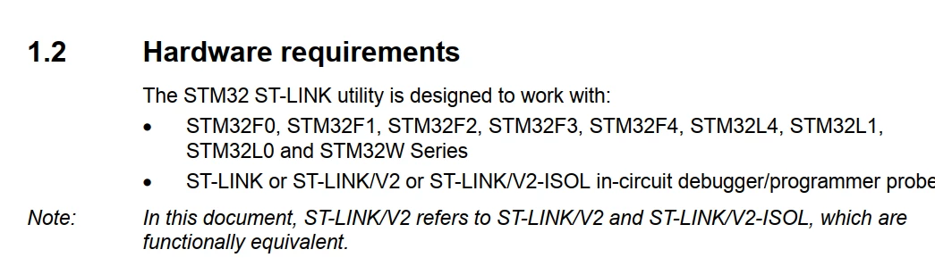

I got the ST-LINK/V2 in circuit debugger and connect the STM8 in SWIM interface and used the STM32 LINK Utility tool to program. But it is not working and giving me the error "can not connect to the target". What I do here? Is STM32 Link utility is for only STM32 families?
AP_040
AP_040Author
Senior
August 30, 2019
I found that STM32 Link utility only works with the STM32 families from the user guide.0690X000009akNuQAI.png
So for the STM8, required STVP tool. Is it?

August 30, 2019
That's correct.
There are other open source tools such as OpenOCD and stm8flash (flash only).
