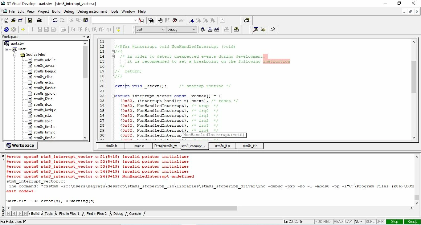

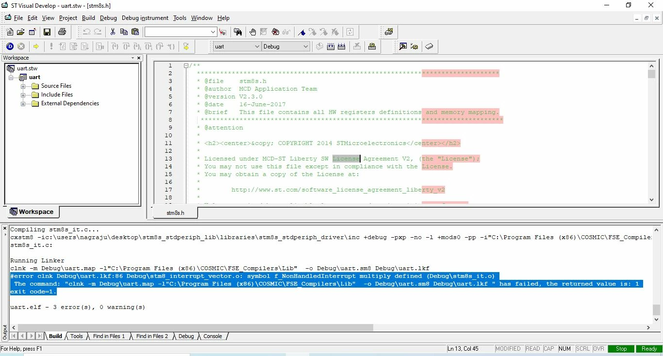

Hello Everyone,
actually iam new these STM8 microcontrollers and i have been trying the basic peripherals, in that process i have started with UART and i tried to compile all the Standard SPL library files and having this error please help me
-PFA-
Thanks
Raj

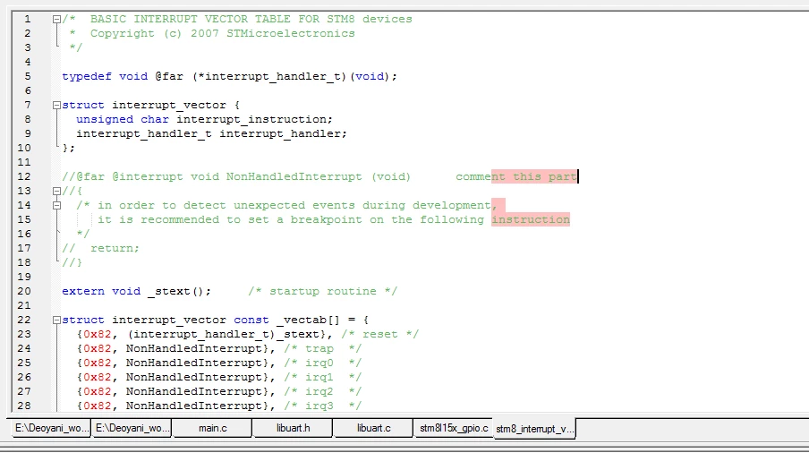

Hello ,
I go the same error. It is resolved by commenting the non handle interrupt in stm8_interrupt_vector.c file .
just comment the non handle interrupt written in stm8_interrupt_vector.c file .
You are getting this error because non handle interrupt is also defined in stm8_it.c /.h file
I am sending you the screenshot too.
please find the attachment.
please answer me if my solution resolved your problem.
thanks
Deoyani

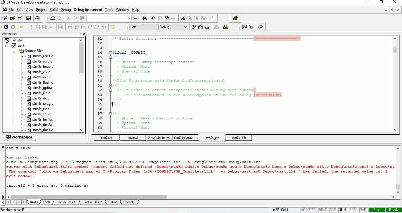

RRaje.1
RRaje.1Author
March 16, 2021
Hi DJosh,
Thank you very much for your support,
i have tried to comment "NonHandledInterrupt" from stm8_interrupt_vector.c file and iam getting this error(PFA), after that i have even tried uncommenting here and commenting the same function from stm8_it.c & stm8_it.h(at same time) then also iam getting the errors(PFA)
please help me
Best Regards,
Raj.

RRaje.1
RRaje.1Author
March 17, 2021
Hi WilkoL,
I have downloaded SPL from ST.com only(i tried again now), and your Uart_config.c file will defenately very useful but only after successful compilation of my SPL libraries.
that means i stuck at the very first step i guess.
please help we to get out of this......
Best Regards,
Raj
