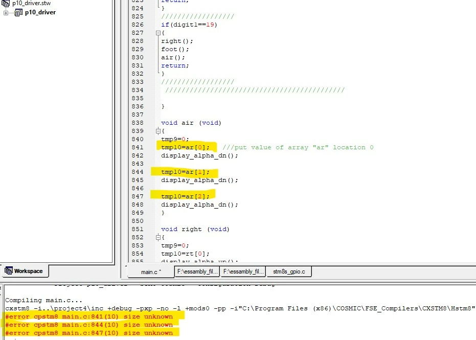

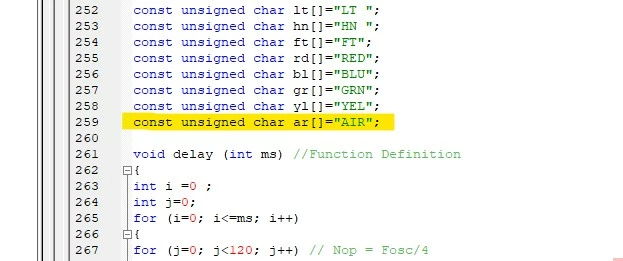

    0693W000003Qzy6QAC.jpgi assigned array like this

    Which compiler is this? Cosmic STM8 compiler?
    Is it a C99-compliant compiler?

    cosmic smt8 compiler with ST Visual devalop IDE

    and amazing thing is, with only few arrays, this error occurs.
    all other dont have such error
    waclawek.jan
    September 9, 2020
    Show example.
    Are the arrays defined in the same file as they are used? Create a minimalistic example exhibiting the problem (and having also the non-problematic example). and show it all.
    You may also try Cosmic support/forum, I don't think there is much experience with it here.

    You could check the manual, perhaps the compiler has switches for standards to adhere to.
    Or, as Jan suggested, the Cosmic support of forum.
    The simplest fix is to define the arrays in the old-fashioned way...

    "The simplest fix is to define the arrays in the old-fashioned way..."
    can u please explain this??
    as shown in last pic, so many arrays are defined but only 2,3 arrays are showing error. all others are ok.
    i even changed the names but no any difference.
