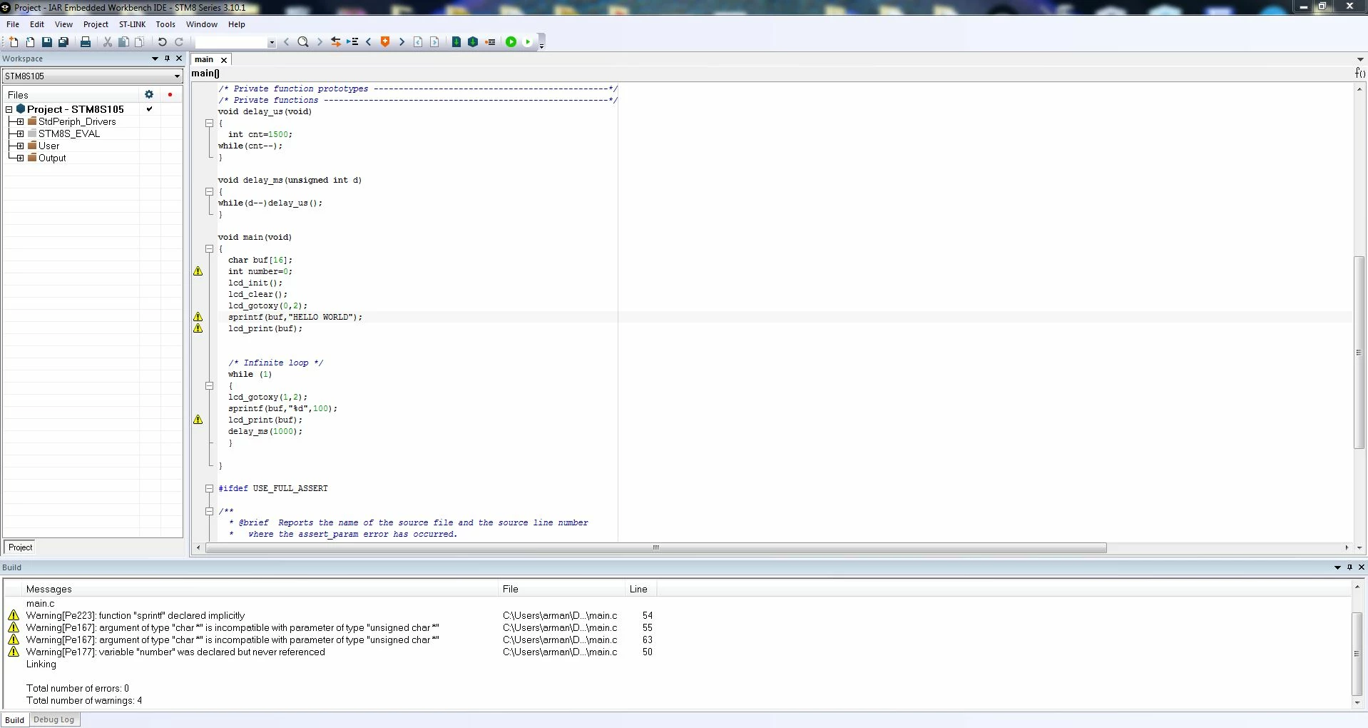

Hi.
I was working with my new stm8s105 MCU trying to get started with the timers.
But every time I use the command to display the time on the LCD the same number showed every time.I thought that the problem is my timer code but when I just put a number on the LCD to show it just showed an irrelevant number.
I use the same LCD.h on LPC1768 and STM32F2 and just converted the same header.The only difference is that I used Keil compiler for them and now I'm using IAR.
lcd_gotoxy(1,2);
sprintf(buf,'%d',100);
lcd_print(buf);
delay_ms(1000);
This is a simple code that must show 100 but it displays 12594
The characters are displayed properly.The problem is numbers.

    The last questions refers to compiler messages like the one you show earlier (spriinf() declared implicitely , etc)

    'buf' variable definition? Is the memory for 'buf' allocated?
    For example, you can reserve some memory this way:
    char buf[100];

    Yeah, the LCD is 2*16 and this is the code.

    Add at the beginning:
    #include <string.h>

    Did it.But no result.

    Is the 'HELLO WORLD' correctly displayed in the position of 0,2?
    Do yo still see 1,2,... instead of 100?
    What messages do you see now?

    I don't know why does this message 'declared implicitly' is shown in the message box and I don't know what is it at all.
    When I use this header in stm32f no such warning appears!!
    Is it the problem?

    >On my LCD or in the message box of the compiler?
    In the compile window

    I was wrong - the sprintf is a part of:
    #include <
    https://pl.wikibooks.org/wiki/C/Biblioteka_standardowa/Indeks_tematyczny#stdio.h
    So include the stdio.h as shown above to clear the message and test it again.

    Yes.My problem is fixed using stdio.h.
