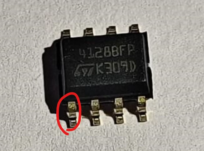

I am currently using the EEPROM part M24128-BFDW6TP (TSSOP-8 package) in a design. However, I’m facing difficulty in locating the Pin 1 marking on the IC. There is no visible notch or dot on the top side of the package that would typically indicate Pin 1, as referenced in the datasheet.
  • The IC top surface only contains part marking text, but no discernible Pin 1 indicator (notch or laser dot).
  • We’ve verified this across multiple units.
  • This is making it difficult to confidently orient the IC for placement.
I’ve attached a clear screenshot for your reference.
Could you please confirm:
  1. The official Pin 1 location with respect to the printed text on the IC?
  2. Whether this is a known marking issue or within tolerance of ST's marking process?
  3. Any additional guidance or recommendations for identification?

Normally, this is the pin 1:
2 replies
July 14, 2025
Pin 1 is on the chamfered side of the chip.
