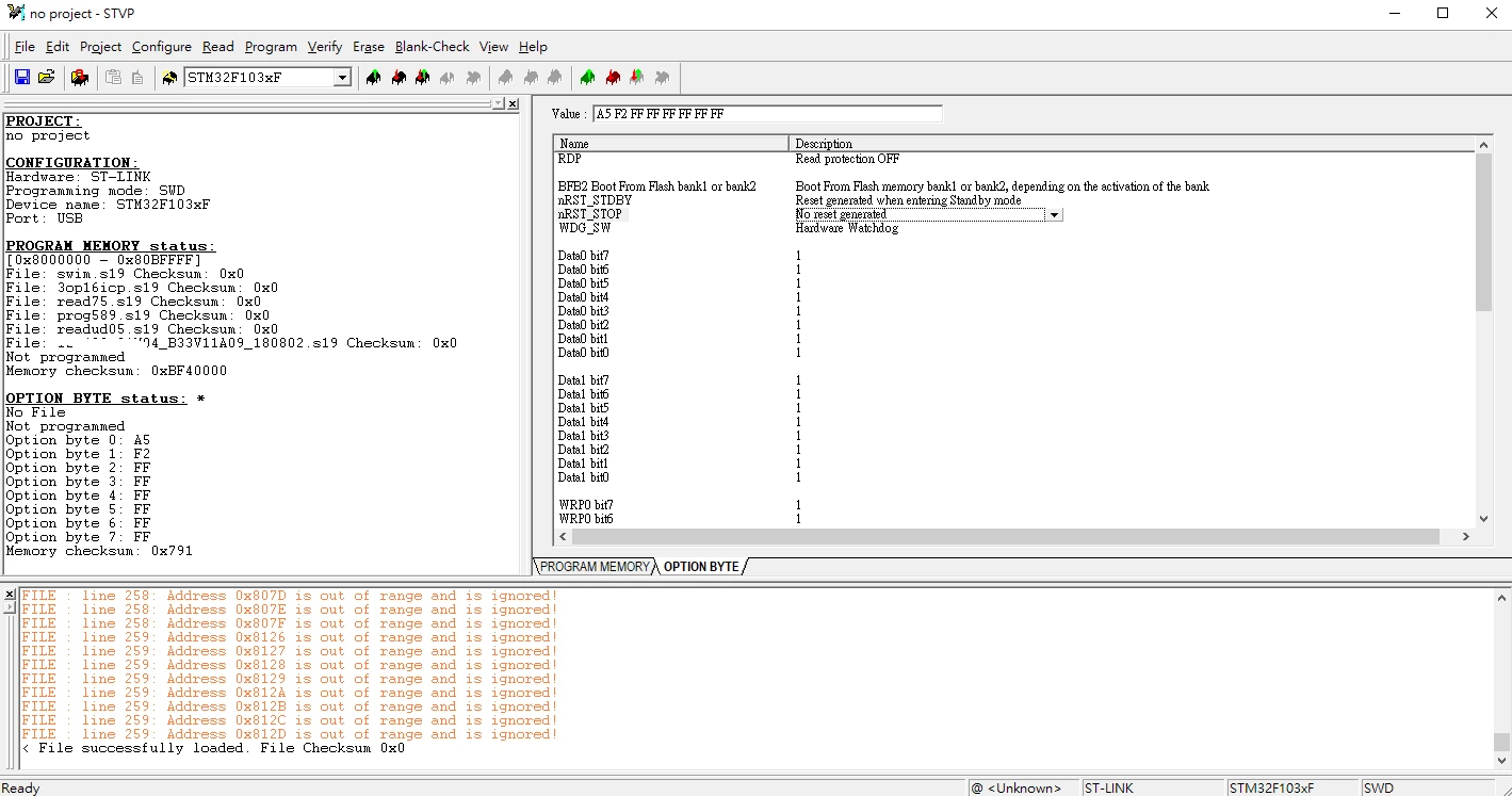

Dear Members of the ST Community,
I hope this message finds you well.
I am writing to seek assistance with an issue I encountered using the STVD-STM8 software. The details of my setup are as follows:
  • Software: STVD-STM8 version 42.0.0
  • Target MCU: STM8S103F3P
  • Context: I compile the .s19 file with Cosmic CXSTM8 (STM8FSE_2025) in STVD and then load it into STVP for checksum verification. However, during the import process, I receive warnings indicating that certain addresses are out of the target memory range.
Previously, I did not experience this issue. After switching computers and reinstalling the software, I now encounter this abnormal behavior.
Additionally, please find attached a screenshot showing the error. Note that some names in the screenshot have been removed in adherence to workplace confidentiality requirements.
Could you please provide any insights or suggestions on why this behavior occurs and how it might be resolved?
Thank you very much for your support and attention to this matter.
Best regards,
Walen

    AA1
    Senior III
    May 2, 2025
    Device name: STM32F103xF.
    STM32?
    walenAuthor
    May 14, 2025
    Hello AA1,
    Sorry for the late reply, and thanks for the reminder! I checked and found it was a configuration mistake on my side, which I've now fixed. Really appreciate your help
