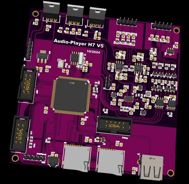

So i made an audio player, similar old CD player : plays wav, flac, MP3 files from 2 SD-cards or USB, or Web-Radio, to 6ch DACs , with IR remote control and small TFT display.
About your performance questions: i run my player on H743 now, had it on F411 at first, but so low on RAM … .
Clock is only 200M , as its more than enough and keeps cpu cool , about +4° from ambient.
The MP3 decoder is miniMP3 in float, output always 32 bit (because ES9038 DAC 32bit type).
CPU load on F411 was about 30% (at 100MHz), minimp3 i float , decoding 128kbit.
So i would say, it needs about 30M cpu time to decode 128kbit MP3 in float, maybe about 70M for 320kbit.
From my buffer setting i just can tell my actual state:
  • i use 4K sample buffers, so 2x 16KB circular for a 2ch SAI 32bit output ( 3 SAI running for 3 DACs)
  • this giving about 40ms time , to fill a buffer at 44k1 or 48k ; at 96k about 20ms
  • input buffer from SDcard is 128K , for MP3 then extra 8K input and 128K output buffer.
  • this also in use when playing MP3 from WiFi (connected to ESP8266 over SPI with separate buffers)
  • after playbuf is filled, the biquad filters run, to get the crossover and correction (all in float)
BUT...everything was running fine, but since some time now a strange problem with the MP3 at 224 or 320k :
seems there are dropouts every 2 or 3 seconds, but no clear noise or tick, just the rhythm of the music is spoiled a little bit,
sounds as if there are bad musicians, that cannot keep a constant beat. The real problem is: i cannot remember, what i changed, what created the problem then. I moved the buffers in RAM areas, changed some buffer sizes , mod flash loader script, etc. - so impossible to remember , what created the hiccup.
And important : always with optimizer -O2 , otherwise...no fun.
SD-card :   (2x SDMMC interface on H743 , was 1x SDIO 4bit on F411 , about 4MB/s read speed (8KB blocks)
I have it in 4bit mode , no DMA , get about 16MB/s effective (= reading in 64KB blocks);
sdcard having 0.5..1ms delay , from command to data coming, so reading very small blocks is wasting time. And sometimes -on old, used cards- can be a delay up to 100ms (!) until data is coming , thats why big RAM area in CPU is fine, the more, the better. :)
Maybe i move for a new design , maybe STM32H5E5  , 1.5MB RAM .
+this is the actual:
