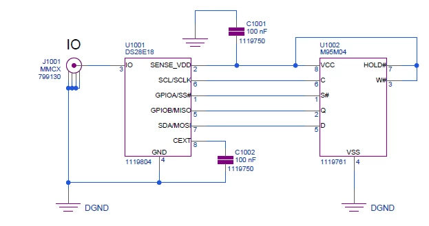

I am trying to use the M95M04 as a SPI slave device from the ADI DS28E18 one-wire bridge. A picture has been uploaded to show the entire hardware setup. My main issue is that whenever I try to send data to the EEprom and then read that data back, I only get FF as a result. When setting write enable or write disable, the MISO line pulls low like would be expected and returns 00. I have used an oscilloscope with a bus decoder to ensure that the correct commands are being sent out of the DS28E18 to the M95M04, and they are. We never see the WIP bit go high, and we have tried many changes in both the hardware and the software. Our current hardware setup is based off of the schematic image I have posted, but there have been some modifications. C1001 has been changed to 10uF X7R, C1002 has been changed to 1uF X7R, and 10k pull-up resistors have been added on the S# and D pins. From the software side, I have attached the code that our software engineer is using. I have tried replacing the EEprom, I have confirmed that the layout on our board is correct, and I have ensured the traces between the DS28E18 and M95M04 are all intact. If someone could please look through our setup and see if there are any obvious flaws that would be fantastic.

The code structure looks broadly reasonable, but two things stand out:
  • W# is tied to VCC in the schematic, which can block writes entirely
  • the EEPROM may still be mis-powered or not selected correctly during the SPI transaction
Also, I would strongly suggest logging the DS28E18 result/status byte after each sequencer run, not just the SPI payload. Additionally, I recommend replacing C1002 (100nF) with a 470nF capacitor, as mentioned on page 2 of the DS28E18 datasheet.

3. Hardware & Power Considerations
A. Powering the M95M04 from SENSE_VDD
In your schematic, SENSE_VDD (Pin 2 of U1001 DS28E18) is driving VCC (Pin 8 of U1002 M95M04).
  • Power Delivery Limit: The DS28E18 SENSE_VDD pin delivers internal power derived from the 1-Wire parasitic / IO line. The current output capability of SENSE_VDD is very limited (typically around 1 mA to a few mA max depending on 1-Wire strong pull-up).
  • M95M04 Current Consumption: The M95M04 (4 Mbit EEPROM) can consume up to 3 mA to 5 mA during write cycles and around 2 mA during active SPI reads.
  • If VCC sags below the minimum operating voltage of the M95M04 (typically 1.8V to 2.5V depending on suffix) during high-frequency SPI clocking, the EEPROM logic resets, resulting in 0xFF output.
Recommended Test: Supply VCC of the M95M04 directly from a dedicated external power supply (3.3V) rather than SENSE_VDD to rule out power collapse.
B. Pull-Up Resistors
  • Adding 10kΩ pull-ups on S# (CS) and D (MOSI) was a good change.
  • Ensure W# (Pin 3) and HOLD# (Pin 7) are strongly tied to VCC (which you have done in the schematic).
  • Verify that S# (Chip Select) goes fully HIGH between separate sequencer transactions. The M95M04 requires a High-to-Low transition on S# to reset its internal SPI state machine for every new command.

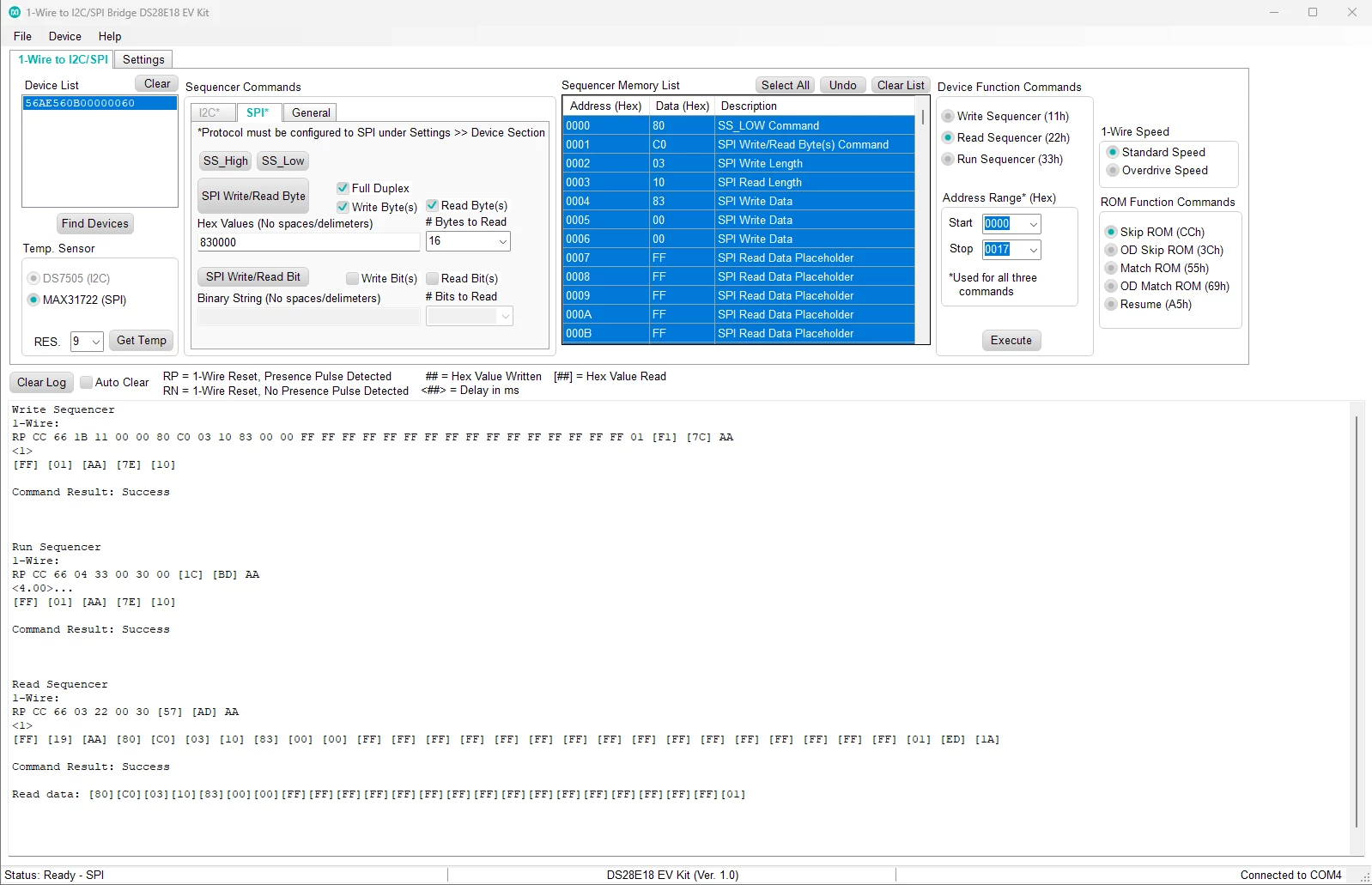

Thanks everyone for your suggestions! The software engineer and I have now tried most of these, but we still have the same issue. We ended up getting DS28E18 and M95M04 eval kits and testing using those. Even using the DS28E18 software and powering the m95m04 from an external 3.3V yields the same results from the SPI transactions. We are looking into getting a different eeprom model to test with.
Here is an image of what we are reading back in the ADI software:
