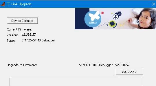

    AJosh.11
    AJosh.11Author
    October 28, 2021

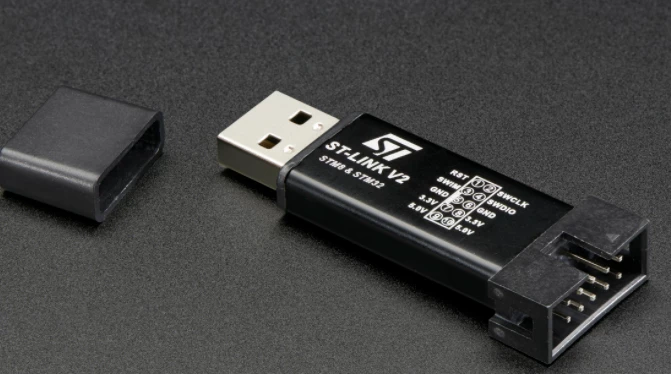

    Thanks for reply,
    My stlink v2 look like below.
    0693W00000FE3PqQAL.pngcurrent version of my stlinkv2 is V2.J38.S7

    Uwe Bonnes
    Chief
    October 28, 2021
    That is not a genuine STlink, but a clone. The cloner may have done anything and actually have broken swim functionality, or ST may have excluded cloned stlinks in recent firmware updates. Ask the real supplier. Double checking you setup is another thing to do,
