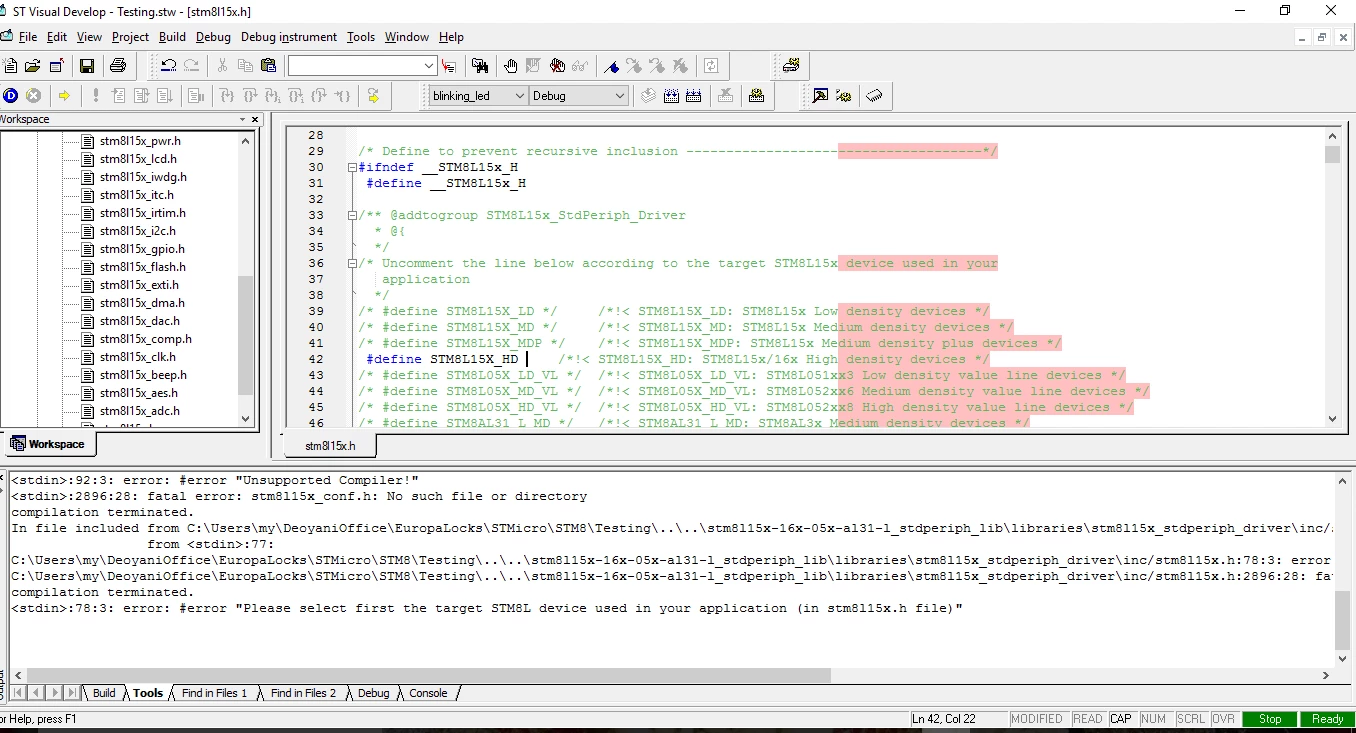

    DJosh.0
    DJosh.0Author
    January 30, 2021
    hello,
    I have done what you have said to me still I am getting an error, I am sending you the screenshot
    I am not getting error in build tab but an error in the tools tab please check this in my screenshot (at the bottom in the output window).
    thanks and regards
    deoyani
    RomainR.
    January 30, 2021
    #error : "Unsupported Compiler!"
    Your project is not build, some project settings are not set properly.
    Is it a project made by you ?
    Step1: Try to open, build and debug an existing STM8L template workspace into
    \stm8l15x-16x-05x-al31-l_stdperiph_lib\Project\Project_template\STVD\Cosmic\STVD_workspace.stw
    Step2: Check all tabs settings into template project, and compare with your settings
    Step 3: Read STVD User Manuel https://www.st.com/resource/en/user_manual/cd00004556-st-visual-develop-stvd--stmicroelectronics.pdf
    Regards

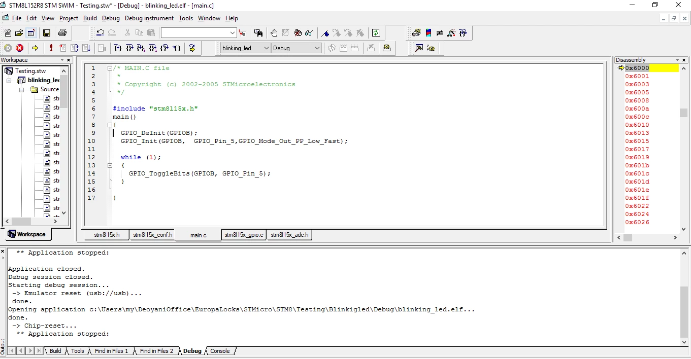

    DJosh.0
    DJosh.0Author
    January 30, 2021
    also, I am getting an error while debugging the code
    I am attaching the screenshot
    please find the attachment and give me the solution
    thanks and regards
    Deoyani

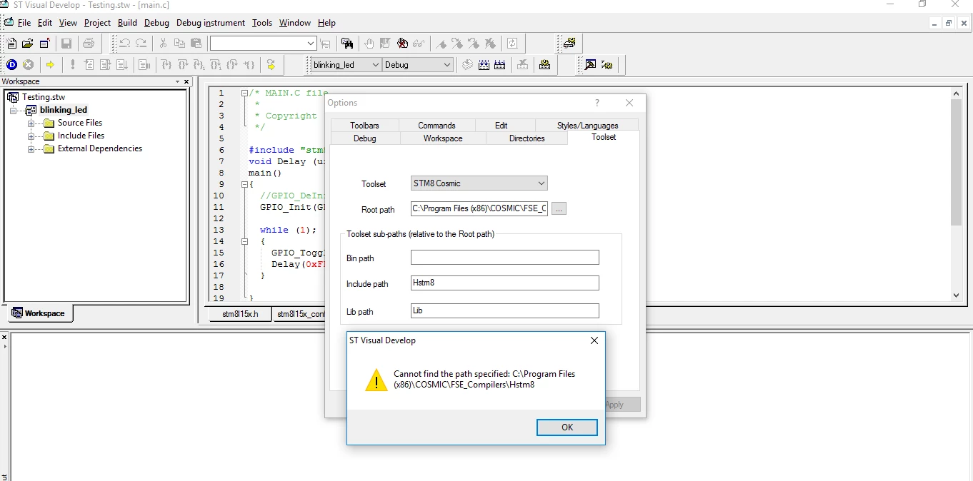

    DJosh.0
    DJosh.0Author
    January 30, 2021
    Yes, I am doing with template folder still I am getting the same issue.
    can you please help to resolve the following issue which is in the attached screenshot
    I am getting this issue after going to tools-> options
    thanks and regards
    deoyani

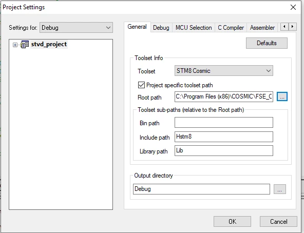

    RomainR.
    January 30, 2021
    No need to set any path here in STVD Options Tab.
    Check if Cosmic STM8 FSE is correctly installed in C:\Program Files(x86)\COSMIC in your computer and the path is need in Workspace Project Settings -> General Toolset Info Tab
    0693W000007DJMZQA4.pngBest regards
    DJosh.0
    DJosh.0Author
    January 30, 2021
    Yes It is the correct path which you have shown
    DJosh.0
    DJosh.0Author
    January 30, 2021
    Thank you so much for guiding me now I can run blinking LED code on nucleo board
