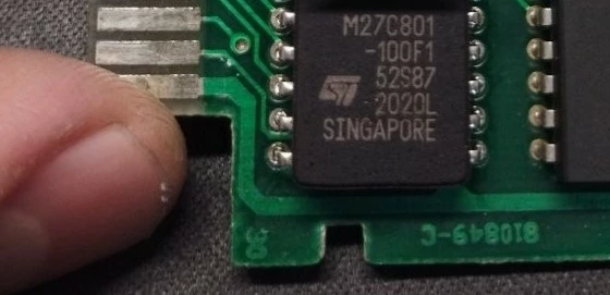

Hello, world. I try to find answer how read that code: 2020L.
Full text on chip are:
M27C801
-100F1
52987
-2020L
SINGAPORE
That 2020L need read like: WWYXX? Or YWWXX? Thank you for answer. Regards

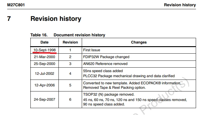

Question are: if that possible that very old ST chip manufactured in 1992?
I'm deducing the age of that part number from the datasheet first release date (I'm just speculating here). First release date is september 1998. So I suppose the device was born around that date.
@Perets  wrote:
can be that from years2020?
No. That doesn't make sense.

There is also a PTN 10/5894 (Product Termination Notice) from 2010, according to which all EPROMs were last delivered in 2011 - so, as @mƎALLEm  said, a very, veeeery long time ago.
Regards
/Peter

Hello  @Perets  and welcome the the ST community,
That product has been obsolete for years.
To answer your question and I'm not sure that's the week of the fabrication: year: 2000 week: 20.
