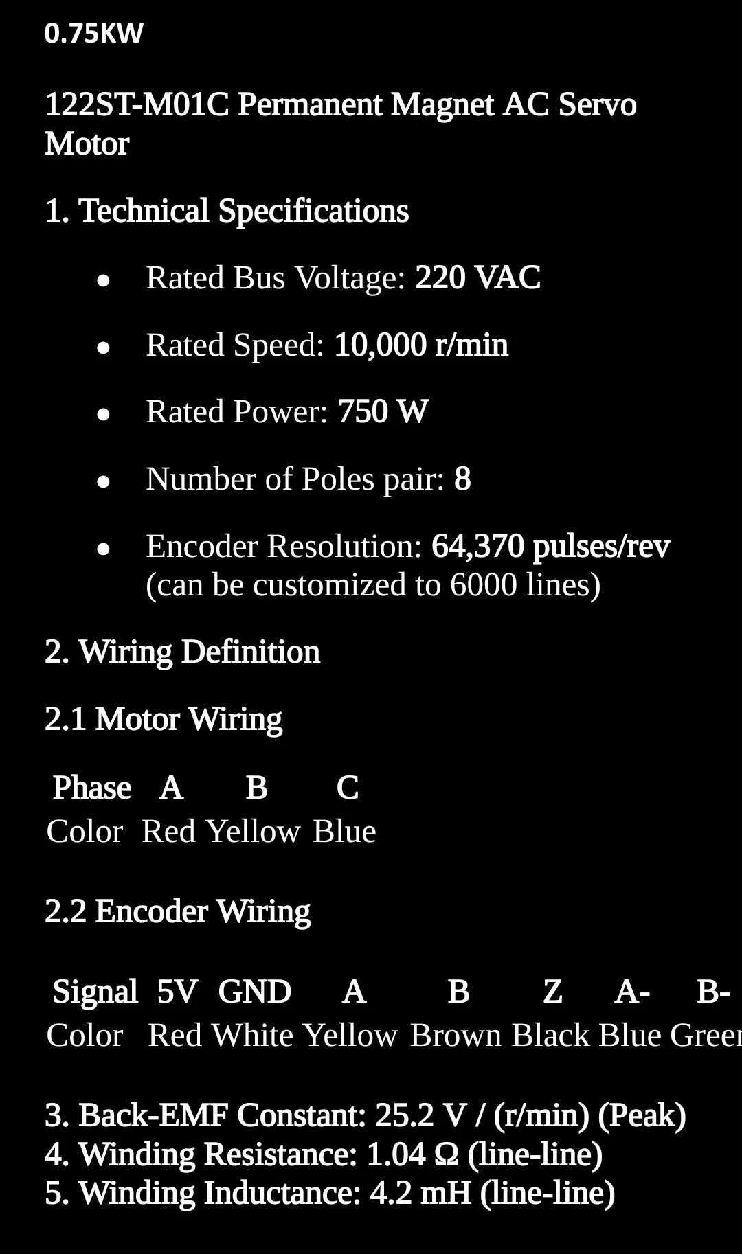

BBasit009Visitor II11 months agoNov 19, 2025 8:27 AM UTCQuestionNeed help in selecting PMSM evaluation board0 replies221 viewsHi,I need to design driver board for the following PMSM motor specs and need help in selecting an evaluation board or related circuitry. Will STEVAL-IHM023V3 evaluation board work? Why is it now NRND? Power management Design center
