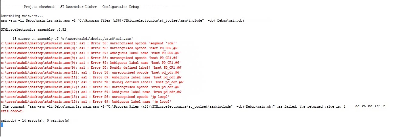

Hello. I want compile a simple program that is :
stm8/
segment 'rom'
PD_ODR EQU $500F
PD_DDR EQU $5011
PD_CR1 EQU $5012
bset PD_DDR,#6
bset PD_CR1,#6
loop2
bset pd_odr,#6
bres pd_odr,#6
jp loop2
end
when I compile this program Stvd get a lot of error that is :
can any one help me??
my windows is 7 and 64bit and I use from STVD and st assembler linker.
Thanks

    You need to start your lines with spaces or tabs, otherwise the assembler assumes you're defining a label.  Like so:
    stm8/
        segment 'rom'
    PD_ODR EQU $500F
    PD_DDR EQU $5011
    PD_CR1 EQU $5012
        bset PD_DDR,#6
       bset PD_CR1,#6
    loop2
       bset PD_ODR,#6
       bres PD_ODR,#6
       jp loop2
       end
