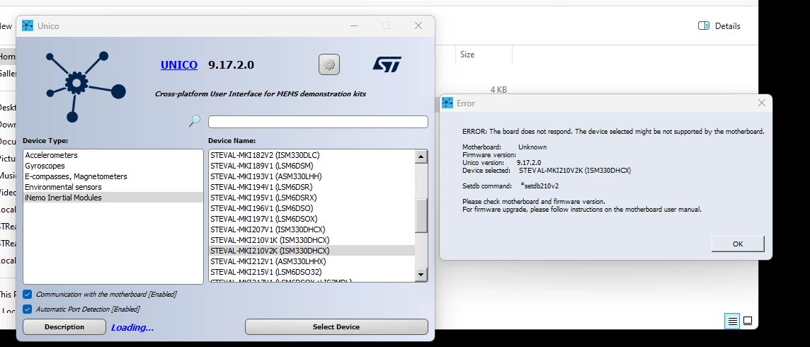

I have finally isolated an example of the error. The MKI 210 accelerometer + the test board is sitting attached to a NUC computer.  The entire setup has run for months with no problems at a REMOTE LOCATION that is very hard to get to without a lot of effort.
Using the software I wrote from your base program in C#, the program is telling me it cannot connect to the accelerometer.
I rebooted the computer over the net and it still gives the same errors.
Now I have trapped one, I downloaded UNICO-GUI to the computer and then ran the program and got the following error.  I checked on one of the accelerometers in my lab and it worked perfectly.
THE ONLY WAY I CAN GET THIS ACCELEROMETER TO WORK IS TO COMPLETELY DISCONNECT THE USB CABLE FROM THE COMPUTER AND LET IT DIE FOR A MINUTE. THERE ARE NO OTHER TESTS I CAN PERFORM -
I do not want to drive a long distance to plug and unplug a cable.
Is there a command I can send the board to do the same thing and overcome the error seen above.
It was working perfectly yesterday as are the other ten devices that are identical.
I have raised this issue before, but your advice would be appreciated as I never got a reply that worked

Not a perfect solution, but there are USB hubs out there that you can control remotely to help debug this sort of thing. It will physically (via an electronic switch) disconnect the device as desired. Something to consider for the future, perhaps.
https://www.usbgear.com/CG-6PU2MGD.html
The USB drivers within the PC are unfortunately prone to this sort of nonsense. Sometimes waiting a few hours (literally) solves the issue, sometimes not.
Enabling/disabing the device and/or the upstream USB controller in Device Manager is also possible but in my experience usually doesn't fix the issue.
