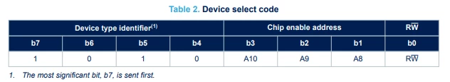

Hello everyone,
It is not clear on M24C16 datasheet, the meaning of A10, A9, A8 (see figure) about chip enable address.
My question is, which is the I2C address for this device?
Is it possible to use two of this devices on the same I2C bus?
Thanks, Paolo

Pierre P.
April 3, 2023
16Kbit (0x7FF) are coded on 11 address bits.
  • A0 to A7 in the address bytes
  • A8 to A10 in the chip enable address.
I confirm: not possible to connect 2 of this 16Kb device on the same I2C bus.
BR
Pierre
Paolo Anterri
April 3, 2023
Hi Pierre,
thank you for your fast reply. I understand now, so if I want to sostituite an old I2C eeprom, that has I2C address set to 0,0,0 (pins A0, A1, A2), this one (M24C16-RMN6P) is not the right choose.
Thanks, Paolo.

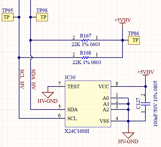

Paolo Anterri
April 3, 2023
Ok Pierre,
in practice I must to replace this device X24C16S8I because it is obsolete. In figure you can see how is connected on the board:
0693W00000bhPoaQAE.pngIs there a eeprom that can replace this, with the same features?
I had identified the M24C16-RMN6P but it doesn't seem to go well....
Thanks for your help.

Pierre P.
April 4, 2023
Hi Paolo,
The M24C16 can be mounted.
See my comments by messages.
BR
Pierre
