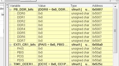

    Please compare the attached files (iostm8sh shipped with the Cosmic, STM8S103F.h shipped with STVD, and iostm8s003k3 generated
    https://github.com/martonmiklos/iarSTM8sfr2cosmic
    from the IAR registermaps). If you see the difference you will understand the reason why I want to get registermaps definition.
    As I have mentioned above generating the headers from the files shipped with IAR and using with non IAR tools explicitly forbidden by the IAR license agreement.
    Believe me I am not whinning here for nothing. Having good header files is essential for embedded development:
    https://jaycarlson.net/microcontrollers/#headers
    And at the another hand the STVD debug view got more readable this way:
    ________________
