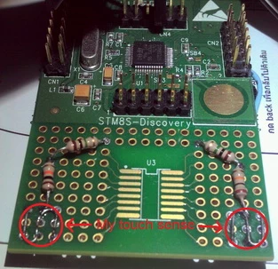

    I recheck config on STM8S105C6.
    My configuration some value wrong.
    Now it's work done.
    But on STM8S103K3 not work.
    in debugging
    sSCKeyInfo[key_number].state
      .whole = 8 '\b'
      .b all value is 0 only ERROR is 1.
    sSCKeyInfo[key_number].Channel
      .LastMeasure = 0
      .Reference = 0
    Then I try step run.
    Set break point at TSL_Action();
    When call TSL_Action(); about 3-4 time.
    sSCKeyInfo[key_number].state.b.CALIBRATION set to 1.
    After that ERROR is set to 1.
    Value never change after ERROR set to 1. (with touch or not touch)
    For STM8S103K3, I use STM8S discovery board by
    remove STM8S105C6 and re wiring from STM8S103's pin to CN1, CN2, CN3 and CN4.
    And connect pin like this
    TL_Load is PE5
    Point touch sence is PB0
    LED is PC1
    Not same as STM8S105C6 because it's easy to wire.
    I guess this information may be usefull.
    I not have oscilloscope but, I try volt meter at TS_Load.
    On STM8S105C6 value is about 2 V.
    but STM8S103K3 is 0 V.
    Now, what can I do next ?

    Max
    Aug 22, 2011 5:00 PM UTC
    Posted on August 22, 2011 at 19:00
    The most common cause of the keys going in error state is when the actual measure is out of the allowed range.
    try changing the SCKEY_MIN_ACQUISITION  and SCKEY_MAX_ACQUISITIONdefinition in the configuration file
    hinnalear
    hinnalearAuthor
    Aug 24, 2011 4:33 AM UTC
    Posted on August 24, 2011 at 06:33
    I found my problem.
    My touch sence button make circuit unstable.
    When I remove my touch sence. It working properly. (Only STM8S103K3, not on STM8S105C6)
    Your guide helpfull to debug problem.
    Thank you very much.
