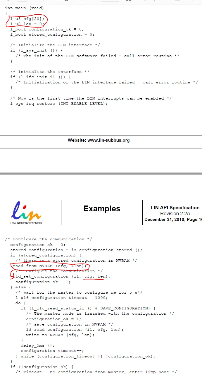

Here's the issue. I have built a LIN bus with a slave node and a master node using tow STM8AF/AL-Discovery boards. After flashing the boards with the demo of the STM8 LIN driver 5.1 as slave node and master node I can control either the LED or the bars in the LCD display with the user buttons. This works fine.
I have a project and the master knode also has no config schedule table, so I have to do the configuration in the slave node.
However, my idea is to pre-configure the slave node so that it does not need the "schTabConfig" schedule table in the LDF file. I have commented out the line in the "lin_basic_demo_master.c" -file and delete the "schTabConfig" in the LDF File.

void l_initTask(void)
 * bring up LIN driver
 l_sys_init();
 l_ifc_init(ifc_used);
#ifndef LIN_21
 l_ifc_connect(ifc_used);
#endif /* !LIN_21 */
 // l_sch_set(ifc_used, LIN_TAB_schTabConfig,0);
 // commented out the line above
 return ;
Now the communication does not work anymore, because the master node does not configure the slave node.
With the function ld_set_configuration() I can configure the slave node, if I understood it correctly.
The function is described in the file "lin_diag_slave.c" or in the LIN Api. The function has three parameters:
  1. param ifc handle of the interface
  2. param data structure containing the *** and all the n PIDs for the frames of the specified ***
  3.   param length length of data (1+n, ***+PIDs)
The first paramter is clear to me, but I just don't know how the "Data" paramter should look like in the demo example. I know, that data it is a array[n] but what values and data are in it?
Where do I get the parameters?
I have attached an example from the LIN Bus spec
I hope you can help me and thank you
Best Regards
Michael
