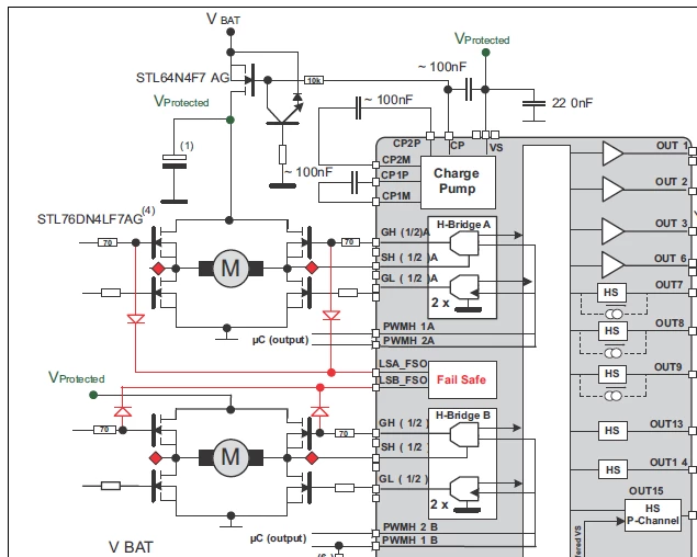

L99DZ200, if there is induce voltage from one motor with H-bridge(FET body diode).
  • November 16, 2023
  • 1 reply
  • 1354 views
we used L99DZ200 for gate driver for running 2ea DC motor at the same time.
if there is induce voltage from one motor with H-bridge(FET body diode) due to generating mode by external load(example by hand), and the other motor is connected to other side H-bridge,
could the other motor work by that induce voltage which is made by one motor in terms of gate driver?
our design circuit is like below picture.

November 24, 2023
could you answer to me about this?
