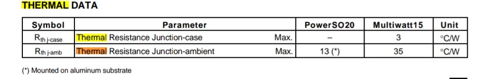

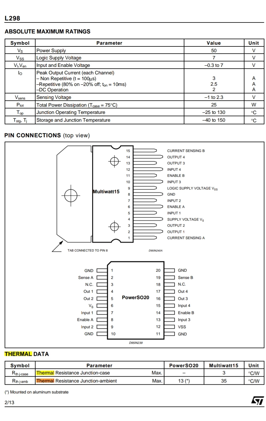

I'm looking for the Thermal Resistance from junction to board  for the PowerSO20.  Do you have this information?
3 replies
Issamos
September 4, 2023
Hello @asubbiah
The Thermal Resistance Junction-case and the Thermal Resistance Junction-ambient are indicated her:
You can find more in this datasheet.
Best regards.

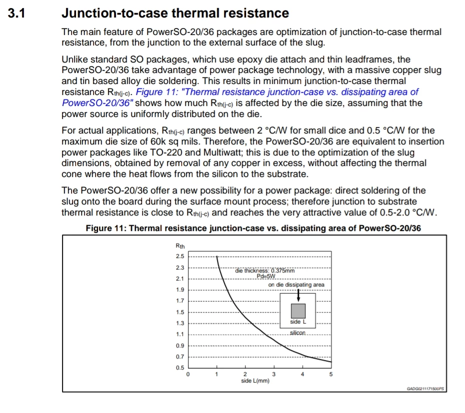

The "-" out number is what I am looking for.  I'm trying to model this as a single resistor for my thermal model.  I am looking for the  junction to board resistance.  Do you know what this value would be? Do you have any guidance on how to model this component to predict junction temperatures?

I think you are looking for this:
that you can find her.
