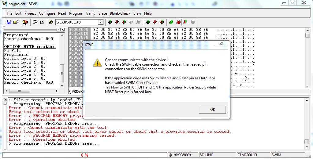

Hello, I'm having some problems with UART1 in STM8S001J3. I'm using the simple code below (the compilation is ok), but when I try to programming the MCU in STVP, a error happen and the MCU doesn't work anymore, even though I try to programming with a funciotonal firmware (like only GPIO port set). Anyone have any idea how to fix this? Or if there is another way to use UART1 in this MCU.
If I put this contidion in DISABLE, the programming process works normally, but UART doesn't work.

When this error happen, MCU doesn't work anymore:
    Best answer by VScar.1
    A simple delay in the start of main void solved the problem. The flash of MCU and UART are working now.
    Odd that when you reconfigure the pin that SWIM is using, it doesn't work subsequently.. Perhaps have some delay between reset, and reassigning it, so the debugger has a window to connect.

    Yes, STM8S001 is a 8-PIN MCU. PIN 8 is a default SWIM of this MCU e and I only use as TX pin. I tried to use PA3 as TX but also doesn't work.
    CLK_PeripheralClockConfig(CLK_PERIPHERAL_UART1, ENABLE);

    PA3 would require a remapped configuration, (AFR0=1 and AFR1=1)
    Pin 8 is bonded to 4 nodes on the internal IC, if you put one in Push-Pull mode it's going to preclude others being used as bidirectional, and you'll be fighting over who can sink the most current.
