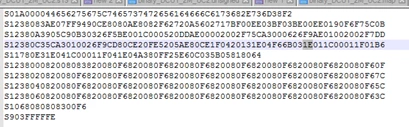

I would like to share an issue I’m facing with a stm8s105c4.
A feature of our main application is to calculate a CRC of the entire program in the flash. Unfortunately, when I read flash data from addresses close to the instruction in execution, the data read it isn’t always correct.
I’ve been able to reproduce the issue in this small program:

In this case, when p_address points to 0x80dc, this is what we can observe in the dissasembly and the core registers:
1)      This set the address we want to read in X
0x80d7 <main+9>            0x1E04         LDW  X,(0x04,SP)
2)     This reads the value in the address point by X :
0x80d9 <main+11>           0xF6           LD   A,(X)
But the data stored in the accumulator (0x8b) is wrong according to the memory view:
Or the Srecord:
On the main application, all the data that was read incorrectly was where a LD or LDW instruction was placed. Also in this example, as 0x80dc has this disassembly:
0x80dc <main+14>           0x1E01         LDW  X,(0x01,SP)
Cosmic and ST Visual Develop was used for this example. I’ve also reproduced this in a stm8s105C6 using a Discovery board. A zip with the project is provided.

    David Beltran Lacasa
    Jan 16, 2019 11:07 AM UTC
    I haven't tried, I had a bit of pressure to find a solution so I decided to forget about the algorithm we were using and switch to the _checksum16 routines provided by Cosmic.
    Then I found out the same issue was happening:
    https://community.st.com/s/question/0D50X00009XkhppSAB/cosmic-checksum16-problems
    The answer to my problem is there: a software breakpoint. I wasn't familiarized with software breakpoints implementations so I didn't figured out before.
