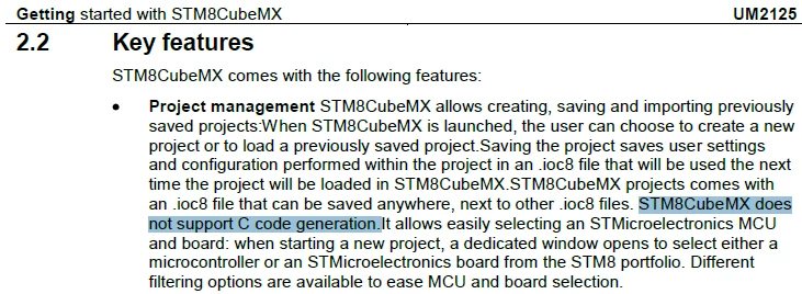

I use STM8cubeMX.
Isn't code generated by STM8cubeMX?
If possible, what should I do?

    Posted on January 22, 2018 at 13:54
    Hello Jeong An,
    Code generation feature is not supported by STM8CubeMX. This tool allows only to:
    • configure MCU's pins and assign them to peripherals in order to check if there are no conflicts
    • configure MCU's clock tree
    • estimate MCU's current consumption for given scenario
    • generate a report with above information
    Regards
