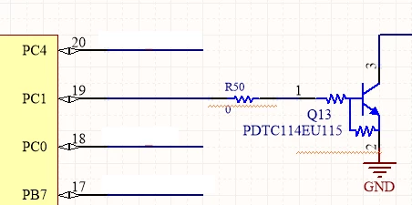

I am trying to use STM8L051 port c pin 0 as an output to drive a NPN. But I find that PC0 & PC1 cannot be set by using ST HAL library. All the registers seems ok (DDR, ODR, CR1 & CR2). And PC4,5,6 can be driven. Can anyone please give me a hand by providing some hints? AHere are the code:

SSin.1
SSin.1Author
January 10, 2023
Thanks for your help.
Sorry for my poor explaination, what I mean is something tlike this:

SSin.1
SSin.1Author
January 11, 2023
Dear Peter,
Thanks a lot! But can you please kindly tell me where can I get the lastest ST offical HAL w/ GPIO_WriteHigh function? The version on my hand is v1.6.1, which doesn't contain GPIO_WriteHigh.
 * @file stm8l15x_gpio.c
 * @author MCD Application Team
 * @version V1.6.1
 * @date 30-September-2014
BTW, GPIO_SetBits has just one line
void GPIO_SetBits(GPIO_TypeDef* GPIOx, uint8_t GPIO_Pin)
 GPIOx->ODR |= GPIO_Pin;
And it can change ODR. So what can I do to modity the function to make it works? Thanks.

Peter BENSCHBest answer
January 11, 2023
Oops, sorry, I got it mixed up with the STM8S family library.
You are right, of course, but you should take into account that on the STM8L051 exactly two pins are so-called true open drain ports - PC0 and PC1. The RM0031 writes about this:
In the true open-drain I/Os, P-Buffer, weak pull-up and protection diode to VDD is not implemented.
This means: to drive an H-level at the output, you must connect an external pull-up, which provides the driving current for your npn BRT.
Regards
/Peter
SSin.1
SSin.1Author
January 11, 2023
Dear Peter,
Thanks a lot! sorry for missing such a point!
