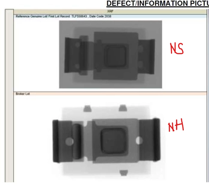

Hi Peter!
that helps alot thank you! however will this affect the difference in the X-RAY?
Peter BENSCH
November 25, 2022
I have no information about the die inside, so I can neither confirm nor deny it.
If you are afraid that they are fakes or counterfeits, you are welcome to send me the bulk ID via private message (please not publicly here, so that it cannot be misused) and I will check whether it is a valid label.
ENeoh.1
ENeoh.1Author
November 25, 2022
I'm afraid we dont have any bulk ID as we bought cut tape for these parts and have no labels to support it. in any case, is there any PCN on the lead frame changing? thanks!!
Peter BENSCH
November 25, 2022
No, there is no PCN related to any lead frame change.
