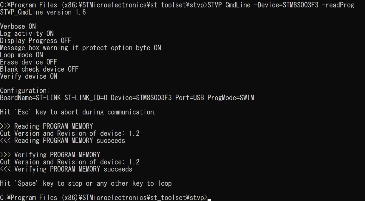

Is there a register that can store and read user-specific information?
​I am developing with STM8S003F3.
I want to store user-specific information somewhere in the flash and read only that area with ST-LINK.
Is there such a way?
Regards,
Gotoda

    Simon V.
    May 24, 2021
    Hello Gotoda,
    STM8 data memory is dedicated for this usage.
    You can refer to programming manual PM0051 (How to program STM8S and STM8A Flash program memory and data EEPROM).
    You should find relevant information in chapter 4 Programming STM8 Flash microcontrollers.
    Regards,
    Simon

    Hello Simon,
    Thank you, I can now write to a specific area of PROGRAM MEMORY.
    Moreover I want to read this via SWIM. I tried using STVP_CmdLine.exe, but I don't know how to get the value of a specific area. Isn't it the -readProg command?
    0693W00000APRgxQAH.pngRegards,
    Gotoda
    Simon V.
    Simon V.Best answer
    May 25, 2021
    I agree with your remark.
    STVP command line tool is dedicated to device programming automation.
    You should use the windows visual version of STVP to read specifically a desired memory area.
    Regards,
    Simon

    I understand that it is difficult to automatically read the values of PROGRAM/DATA MEMORY on the production line.
    Thank you.
