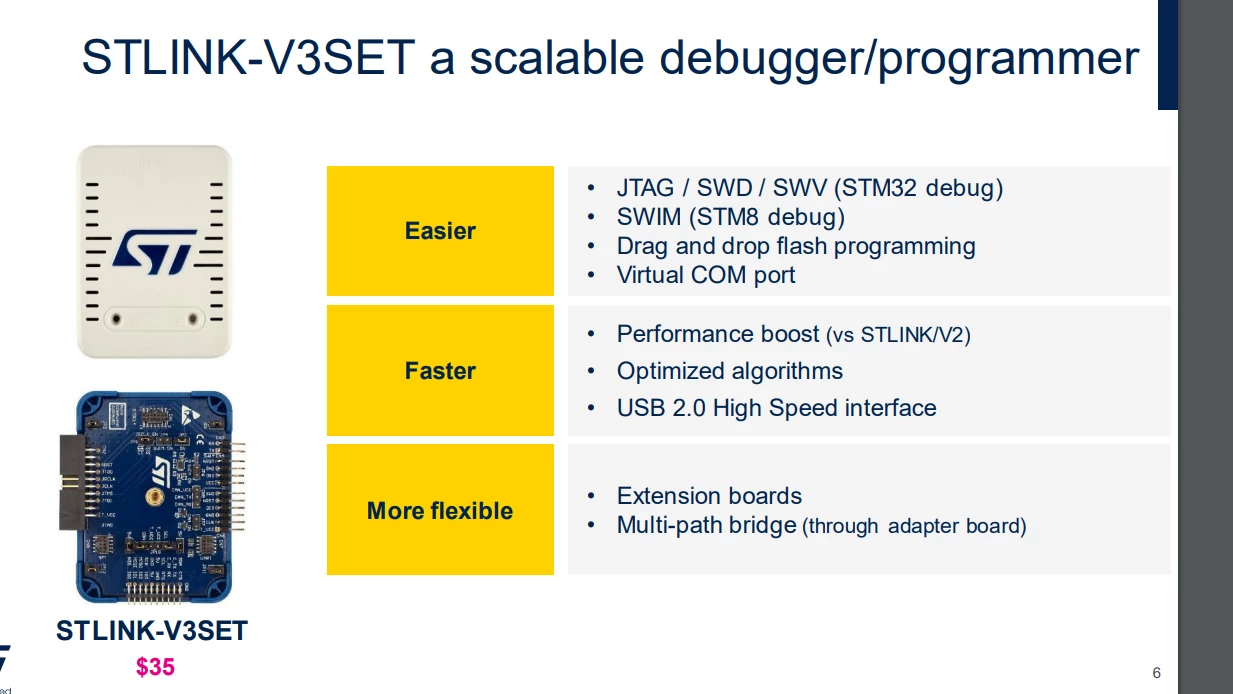

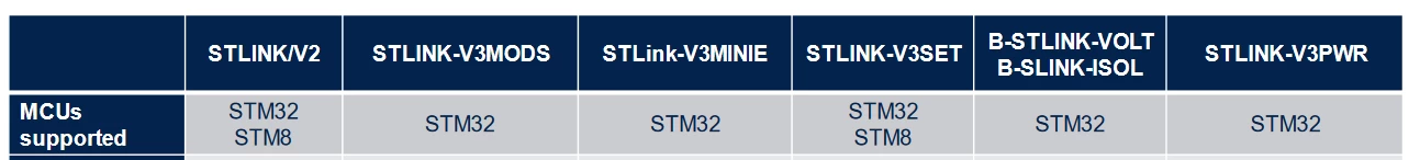

    Brilliant! Many thanks for this I really struggled to find a definitive answer.
    Look like I need the STLINK-V3SET variant.
