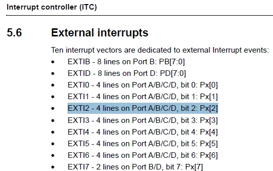

- MCU : STM8L101K3
I am using Port A.2 for interrupt and Port D.2 for general gpio.
GPIO_Init(GPIOA,GPIO_Pin_2, GPIO_Mode_In_FL_IT);
EXTI_SetPinSensitivity(EXTI_Pin_2, EXTI_Trigger_Falling);
GPIO_Init(GPIOD, GPIO_Pin_2, GPIO_Mode_Out_PP_High_Fast);

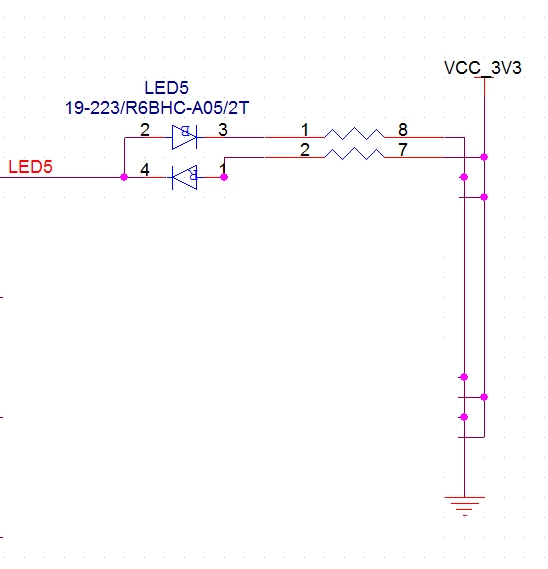

In my scenario, Port D.2 is changed input to output mode per every 1sec.
if(onesec)
   onesec = 0;
   GPIO_Init(GPIOD, GPIO_Pin_2, GPIO_Mode_In_FL_No_IT); // all led off
   if(redled)
      GPIO_ResetBits(GPIOD, GPIO_Pin_2); // red led on
   else if(blueled)
      GPIO_SetBits(GPIOD, GPIO_Pin_2); // blue led on
   else //led off
      // nothing.
If this condition is redled, The EXTI2_IRQHandler that will not expected is called.
The Port A.2's hardware line is not interrupted in oscillscope.
Please know me why
EXTI2_IRQHandler is called?
Thanks in advance.

    EXTI controller is designed is a way, that EXTI[number] is connected to all Px[number] pins. This means that EXTI2 IRQ handler will react on signal change on very pin, which has 2 in the name: PA2, PB2, PC2 andPD2. Pleas see below the extract from MCU's reference manual.
    I believe that this could be an explanation of the bahavior, that you faced.
    Regards
    Szymon
