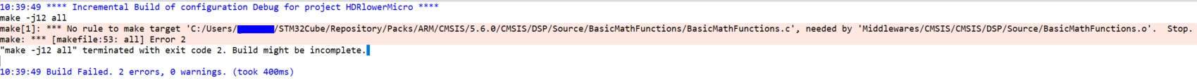

Ok that seems to have eliminated most of the errors. I'm getting a new one now though:
0693W000007DSSvQAO.pngThe filepath is addressing the right user now (me). I think this new error is caused by using a different compiler than the one originally used by the project creator. I tried cleaning and building but no luck.
CGrov.1
CGrov.1Author
February 1, 2021
I got past this error by changing to an internal builder
Project->properties->C/C# builder-> builder settings.
Now dealing with an issue of the IDE not generating a .elf file.
