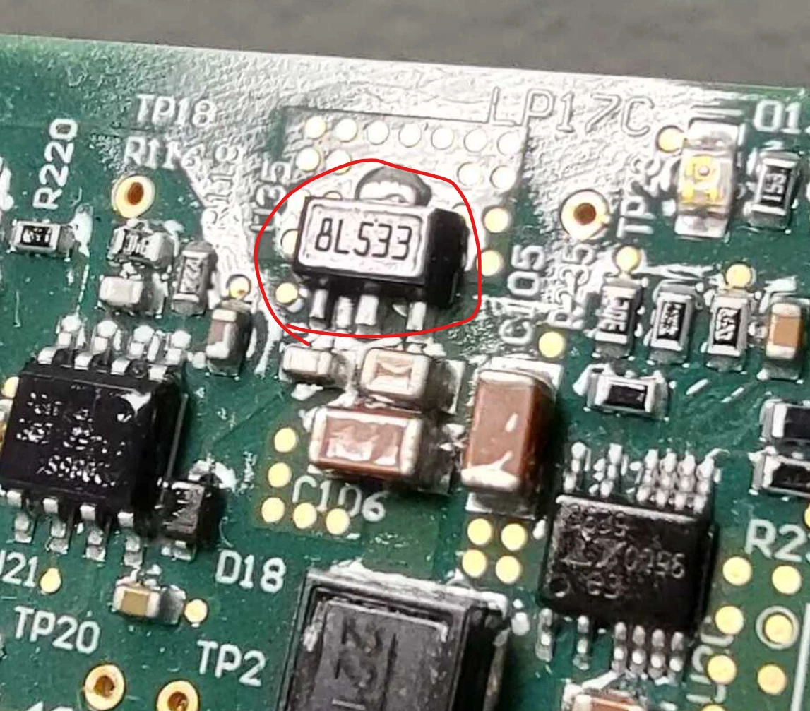

I’m trying to identify the part number of a STMicroelectronics LDO that is on one of our boards to verify it is the correct part through the device marking. I saw on another forum post that the device marking decoding information is something that only STMicroelectronics has access to internally. Could I please get help identifying the part circled in red by it device marking? It looks like it say 8L533. The part is supposed to be L78L15ABUTR.

Welcome ​@john.sharp, to the community!
In some datasheets, the marking information can indeed be found, and the L78L is one of them. You can therefore find the confirmation in the datasheet, table 30: the marking 8L stands for L78L15ABUTR.

Ah I see. Thanks Peter! So are the numbers following 8L just a date code?

Yes, the following characters are the date code: YWW, i.e. last digit of the year and the week number.
