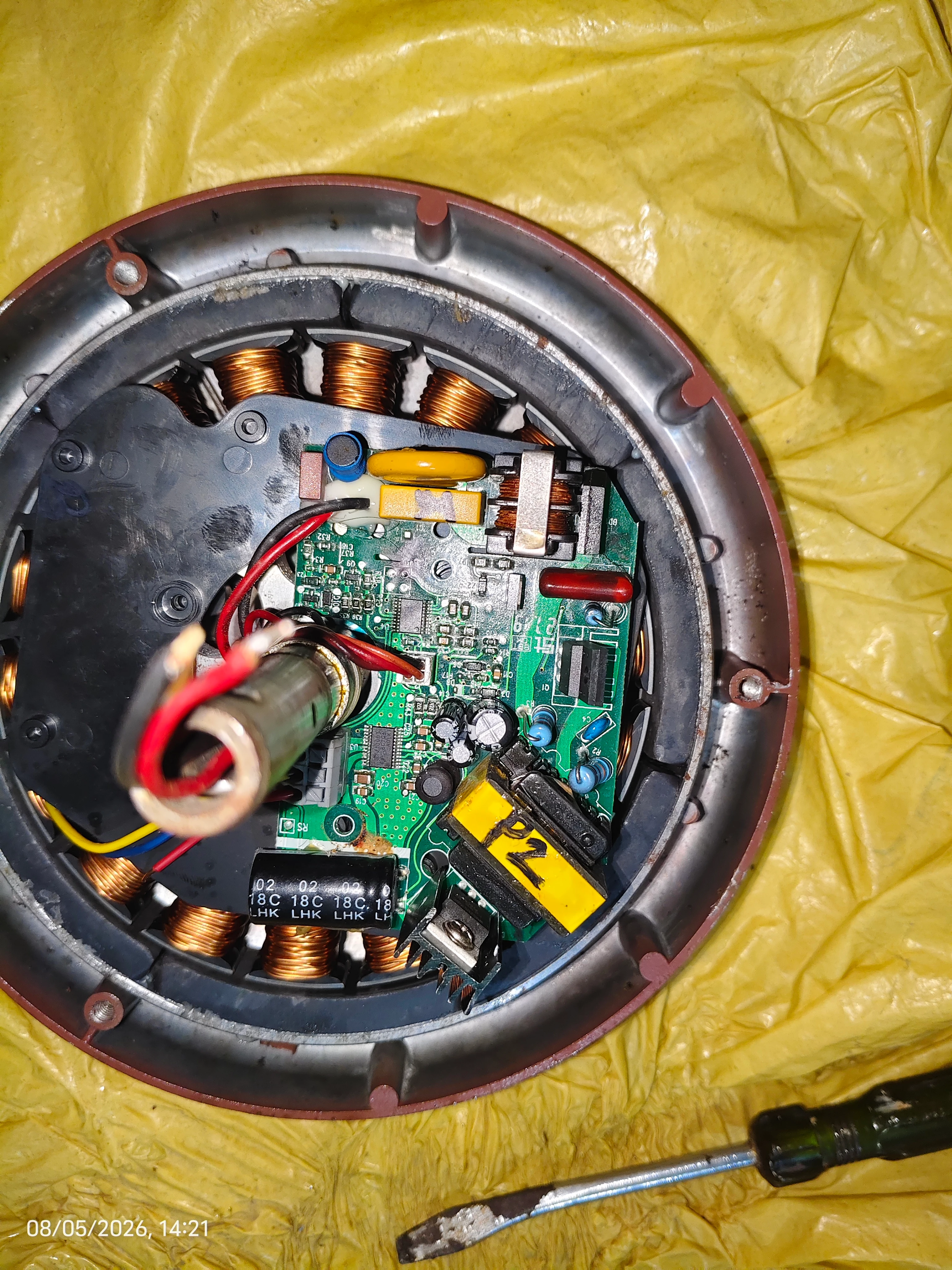

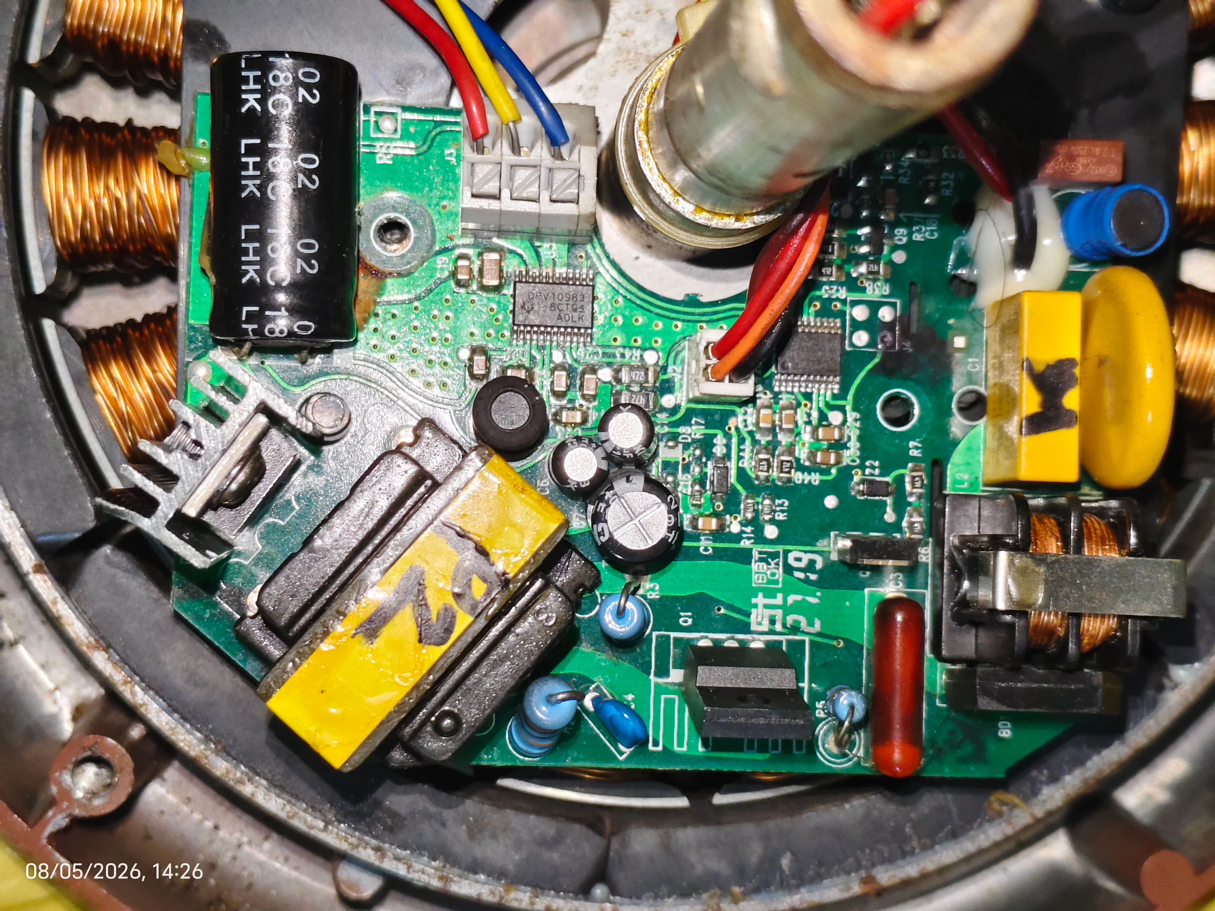

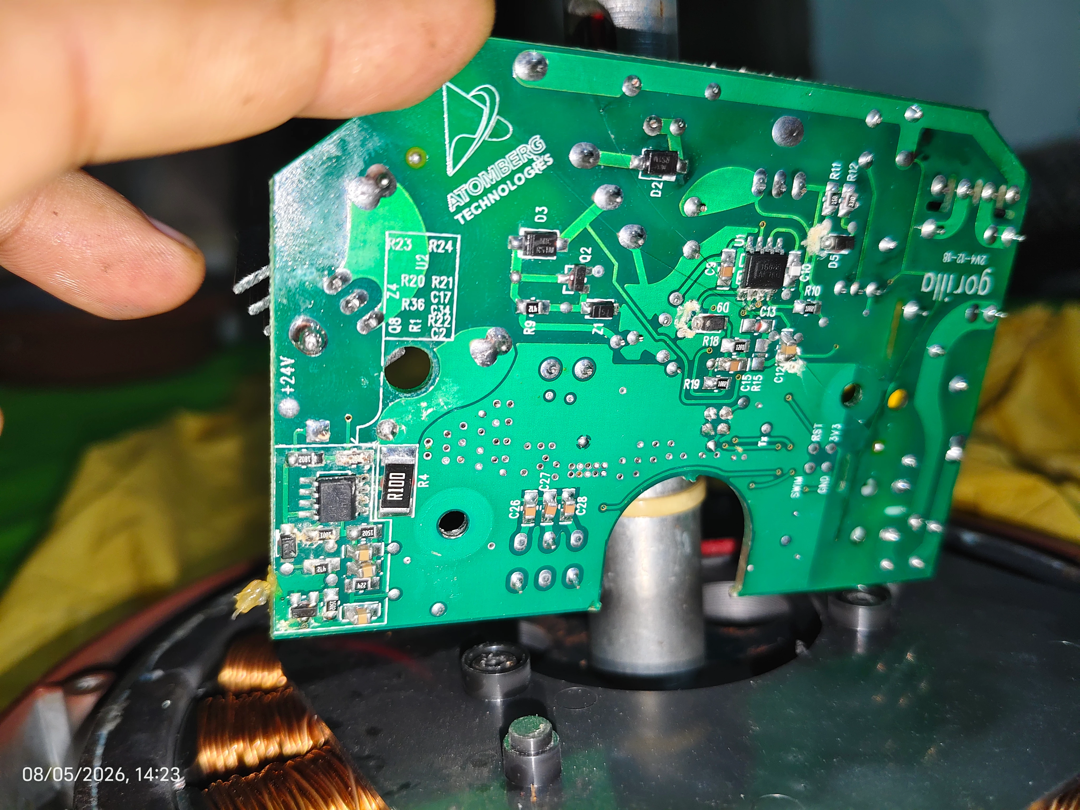

I'm trying to identify an STM8 microcontroller on a BLDC ceiling fan motor-driver PCB (JV2-Gorilla-2017 Atomberg fan appliance board, not an ST eval board), with the goal of confirming whether I can reprogram it via the exposed SWIM header.
What I've confirmed so far:
  • A 4-pad unpopulated header silkscreened SWIM / RST / 3V3 / GND

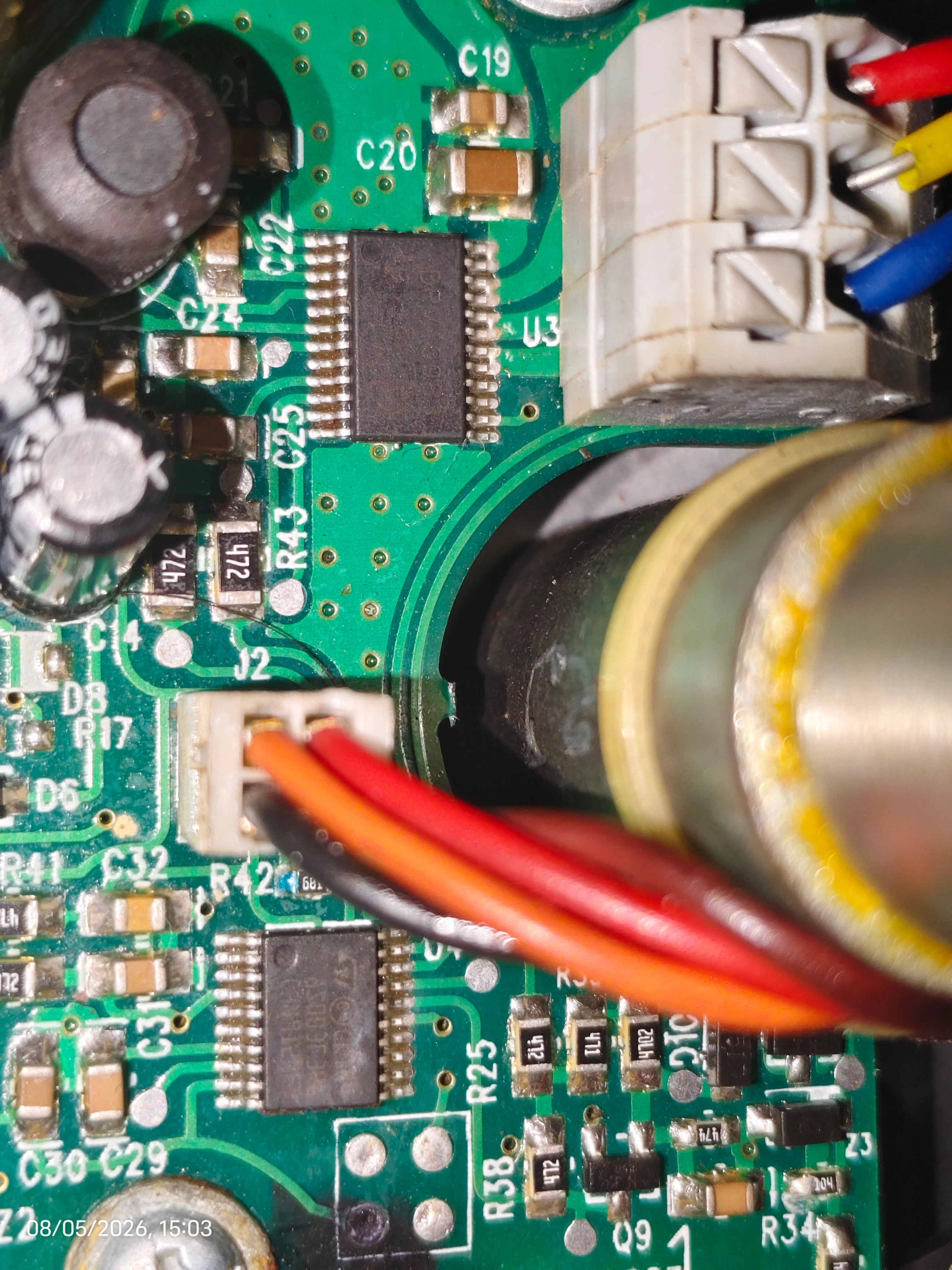

  • Two TSSOP-20 ICs on the board (designators U3 and U4 in silkscreen)
  • U4 shows a visible STMicroelectronics logo under magnification, but the part-number text beneath it is too worn/corroded to read reliably even after cleaning with isopropyl alcohol and raking light
  • U3's top marking is fully illegible (possibly unbranded, possibly just more worn)
  • Board also has a separate 8-pin SOIC gate-driver-looking IC, a 3-pin Hall-sensor connector, and a 3-phase MOSFET bridge under a heatsink — consistent with a BLDC commutation + speed-control board

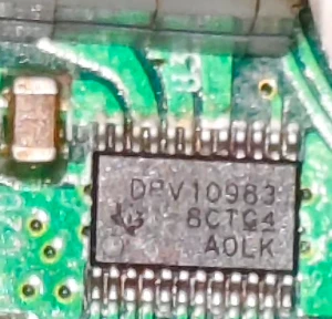

AScha.3
Aug 8, 2026 7:21 AM UTC
from your pic:
...and U3 is probably :  DRV10983 BLDC driver
https://www.ti.com/product/de-de/DRV10983
