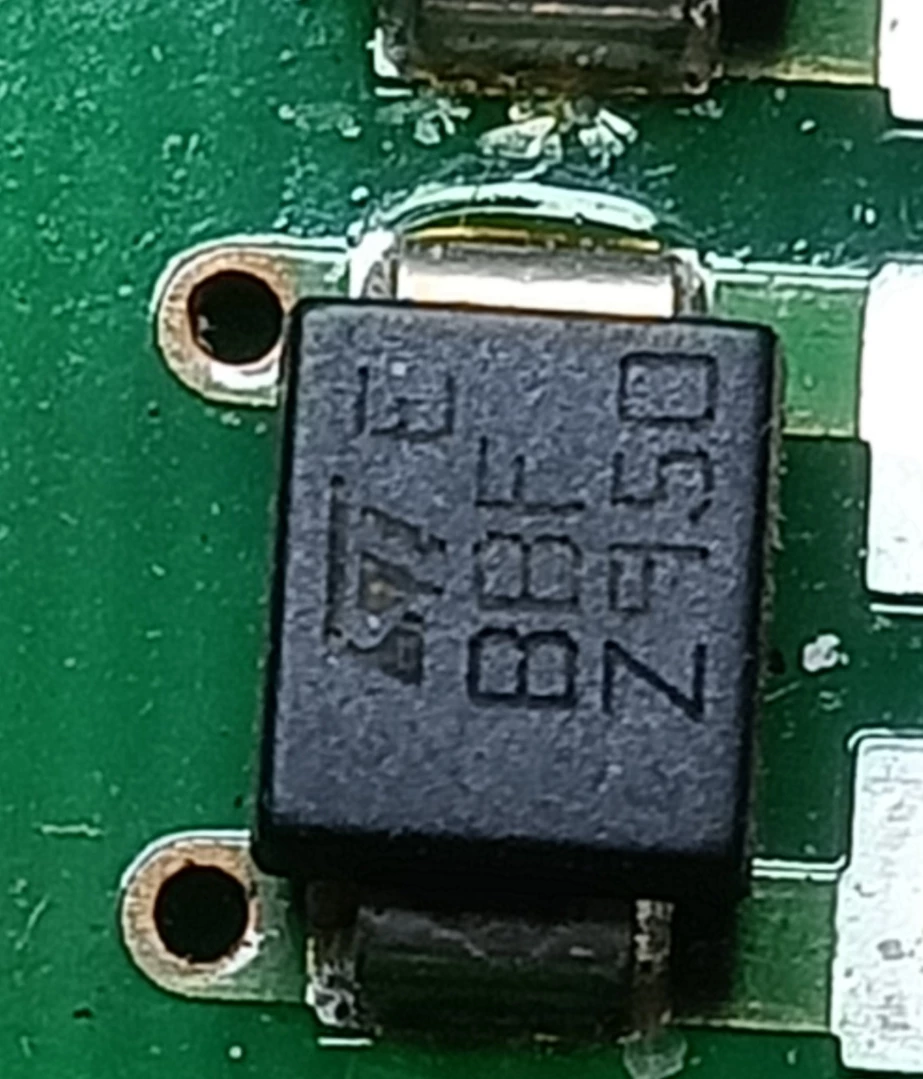

buon giorno a tutti sapreste indicarmi che tipologia di diodo è questo l'unica cosa e che è bidirezionale per il resto non riesco a trovare nessun datascheet

    Looks like it's a SMBJ13CA based on the BBF marking. TVS diode.
    https://www.st.com/resource/en/datasheet/smbj58ca.pdf

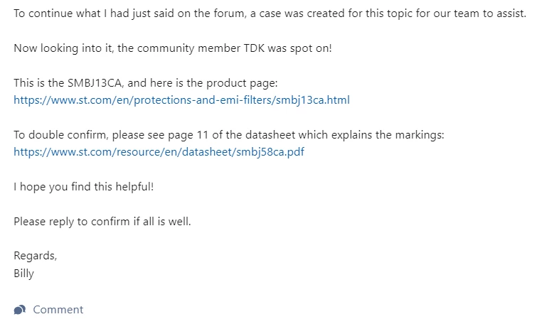

    Billy OWEN
    October 25, 2023
    Hi @Imerio
    The forum moderator had marked your post as needing a little more investigation and direct support. An online support case has been created on your behalf, please stand by for just a moment and you will hear from us.
    If anyone else has similar types of questions, please feel free to open a support case directly at http://my.st.com/ols
    Regards,
    Billy

    Billy OWEN
    October 27, 2023
    Hi @TDK
    No, that is not the case at all! I apologize that you take our responses like that.
    We just have a process, and when a forum moderator "flags" a post, it creates an internal Support case for our team. So I (we) just follow the process set in place and answer directly, regardless of what answers before, or after are given.
    Here, I will even show you, in this case I both mentioned you and gave you some credit :)
    Cheers!
    Billy
