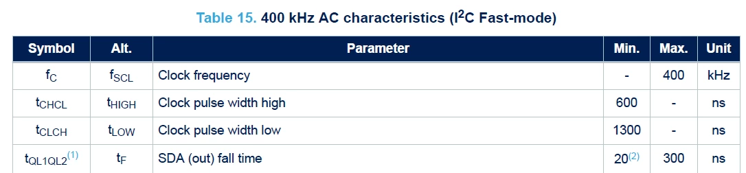

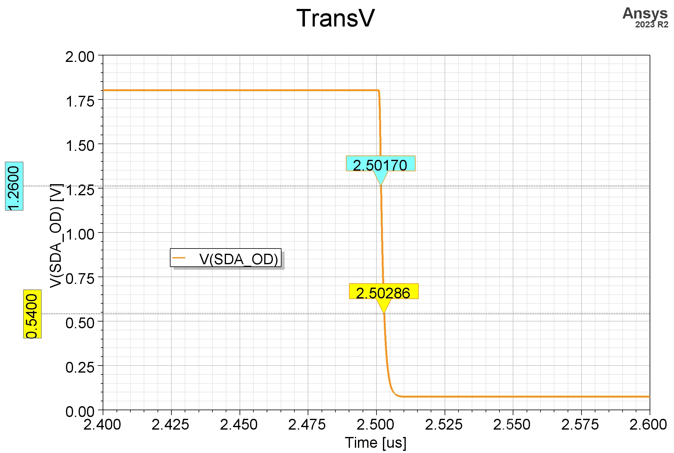

I simulated the SDA with IBIS model downloaded, but I realize there is mismatch comparing the result to the datasheet. It's stated with Cload 10pF, the tF SDA falling time is minimum 20ns and max 300ns.
With the ibis model, the same Cload, the falling edge is only 1ns
Could you please take a look at that. Thanks.
