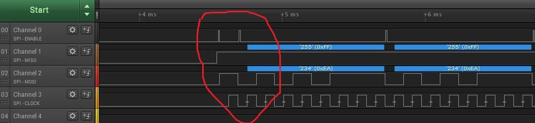

There is a problem with the transfer on SPI how to track that this left?! Here is the function code for the transfer of bytes via SPI and a picture with a logic analyzer, circled in red, what confuses me is that for a glitch!
void init_SPI(void)
  CLK_PCKENR1 = 0x02; // Включаем тактирование SPI
  PC_DDR|=(1<<6)|(1<<5)|(1<<4);//MOSI(6) SCLK(5) CS(4)
  PC_CR1|=(1<<4);
  PC_CR2|=(1<<4);
  SPI_CR2|=(1<<1)|(1<<0);//CS Sofware
  SPI_CR1|=(1<<5)|(1<<4)|(1<<3)|(1<<2); //Fmaster/256, режим Master
  SPI_CR1&=~((1<<1)|(1<<0));
  SPI_CR1|=(1<<6);// Включаем SPI
void spi_send_2(unsigned char dummy)
  unsigned char tmp;
SPI_DR=dummy;
while (!SPI_SR_bit.TXE);
void cc1101_strobe(unsigned char s)
PC_ODR&=~(1<<4);
spi_send_2(s);
PC_ODR|=(1<<4);
void cc1101_init()
int a;
PC_ODR&=~(1<<4);
cc1101_strobe(SRES);
for(a=0; a<74; a++)
spi_send_2(cc_config[a]);
PC_ODR|=(1<<4);
delay(100);
