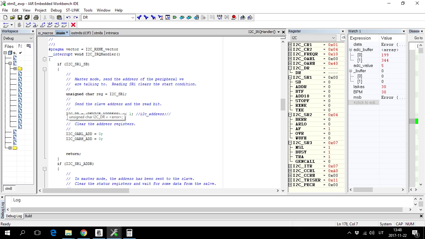

I2C not working on STM8S103K3P6. what am I doing wrong?

    What exactly is not working? Do you have the same issue as in this thread ?

    First, somehow DR (data register is not showing anything), I clean ADDR by reading SR1 and SR3, clean TXE by writing DR twice, but can't get any data to buffer from MXL90614 temperature sensor

    Well, the code *may be* correct - though it does not use the official STM library for i2c and system clock.
    You need to hook a logic analyzer on i2c lines and see what the host sends and what the sensor answers.
