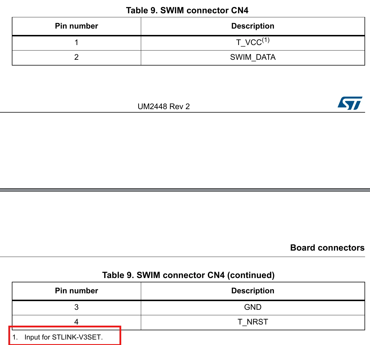

I want to STLINK-V3SET Connected STM8L152C8 by self power.

How are  STLINK-V3SET self power connection?
ST Visual Develop(4.3.12) or ST Visual Programmer(3.4.1) unknow self power selection.

    The STLINK-V3SET cannot source power from the SWIM connector, you have to supply power for your target independently from the debugger:
