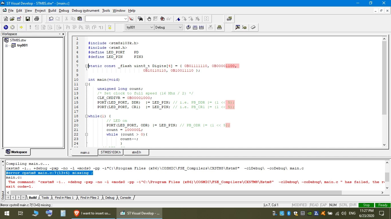

    Thanks for the reply, Let me try it. So far I was using ATMEL. This is my first try with ST. I am using STVD with cosmic compiler. Meanwhile can you please check, whats wrong with this. It is giving error.
    #include <stm8s103k.h>
    #include <stm8.h>
    #define LED_PORT  PD
    #define LED_PIN   PIN3
    static const _flash uint8_t Digits[4] = { 0B01111110, 0B00001100, 0B10110110, 0B10011110 };
    int main(void) {
    unsigned long count;
    CLK_CKDIVR = 0B00001000;
       PORT(LED_PORT, DDR) |= LED_PIN; // i.e. PB_DDR |= (1 << 5);
       PORT(LED_PORT, CR1) |= LED_PIN; // i.e. PB_CR1 |= (1 << 5);
    while(1) {
        PORT(LED_PORT, ODR) |= LED_PIN; // PB_ODR |= (1 << 5);
         count = 100000L;
    while (count > 0)
    { count--; }
        PORT(LED_PORT, ODR) &= ~LED_PIN; // PB_ODR &= ~(1 << 5);
         count = 100000L;
    while (count > 0)
    { count--; }
    return(0);

    Does it accept binary constants?
    KSahn.1
    KSahn.1Author
    June 24, 2020
    Yes it does. I used it again CLK_CKDIVR = 0B00001000; in line-12.

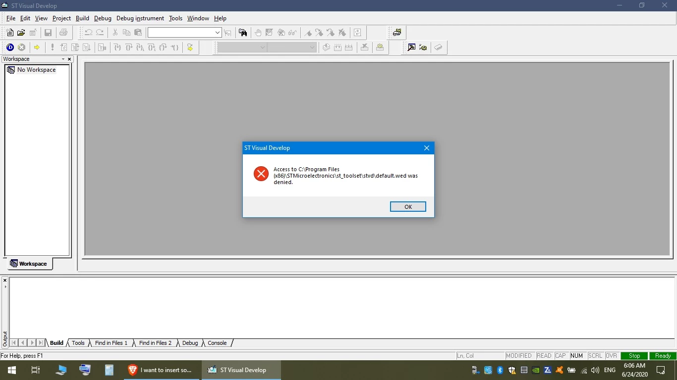

    Sir, one more reason I might be overlooking. It is showing a message at startup. Can you please check this.0693W000001rLpjQAE.jpg
    KSahn.1
    KSahn.1Author
    June 24, 2020
    Dear Sir, I changed the settings to ST Assembler Linker instead of Cosmic, and it compiled well. No errors. Now can I program this file with S19 extension directly to my chip ????
