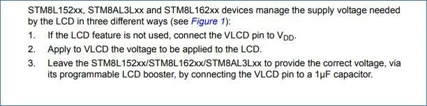

I use STM8L152 in my PCBA. Since I don't use LCD function, so I don't connect anything to pin9 VLCD and I don't set any LCD register in my firmware. Is there any thing must be configured with pin9 VLCD for normal use of STM8L152?

On the STM8L152 devices, If the LCD feature is not used, you must connect the VLCD pin to VDD.
I advise you to have a look at the AN3029 Application note “Getting started with STM8L and STM8AL�?, is very helpful:

Hi Imen, noted and thanks, but for some reason, I have to let pin9 VLCD floating and it seems that MCU works mormally now.
So could you please advise is there any potential risk?
