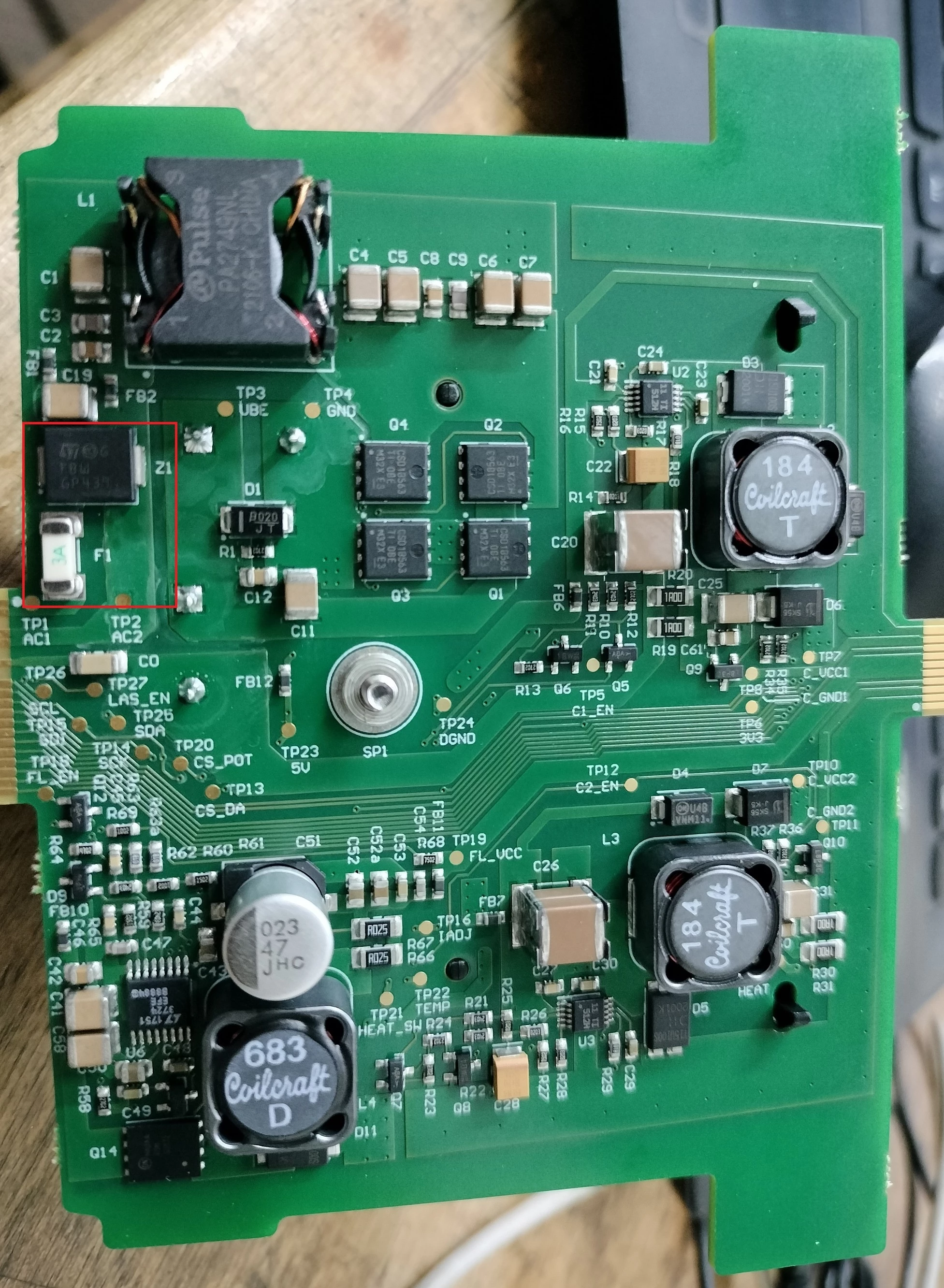

Please be informed that the attached JPG file is power card for CCTV camera, the supply , The camera is connected to an operating voltage 24-28 ACV.
i need to know the part No. of  Z1.
Please check and wait your advice

FBW  SMCJ48CA-TR

Hello @Mostafa
Can you add your power card reference.

Don't you have any indication on the name of this board, any reference. If you don't, can you give as a product using this card.

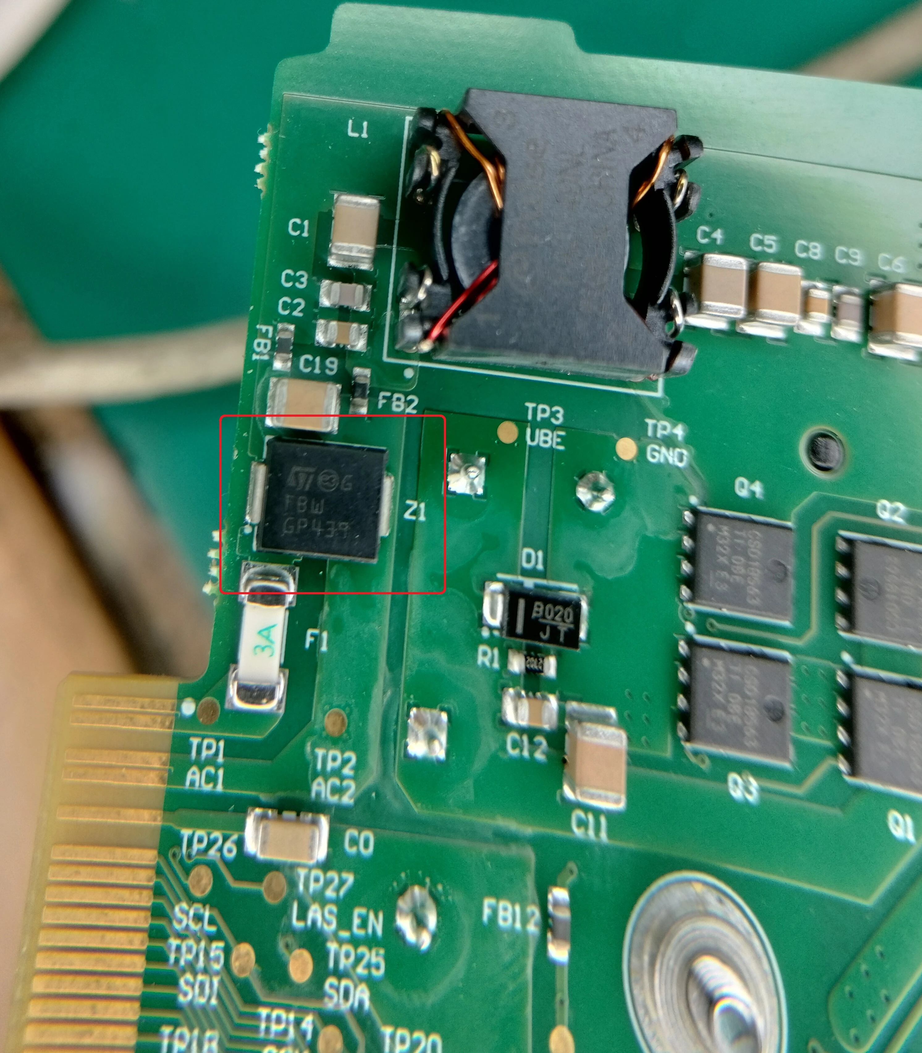

written on this item the next
FBW
GP439
and logo for  ST microelectronics company
best Regards
Mostafa
Issamos
September 10, 2023
Can you give the name of the board in the picture or at least the name of the system using that board. That can help as finding the reference of the components you are looking for.

FBW  SMCJ48CA-TR
MostafaAuthor
September 11, 2023
dear Mr.Tesla .. good day. i confused from your reply.I sent an enlarged picture of the Z1 so you can read the written data. wait your advice. best Regards

I don't understand your problem? I gave you a specific part number, and you provided a larger more poorly focused picture of a part we've already seen and decoded the marking from..
